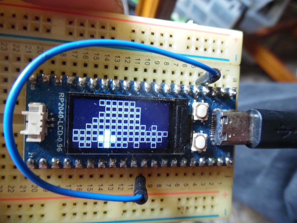

I bought one of these, waveshare?? it got mentioned ages ago.
