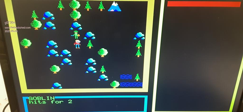

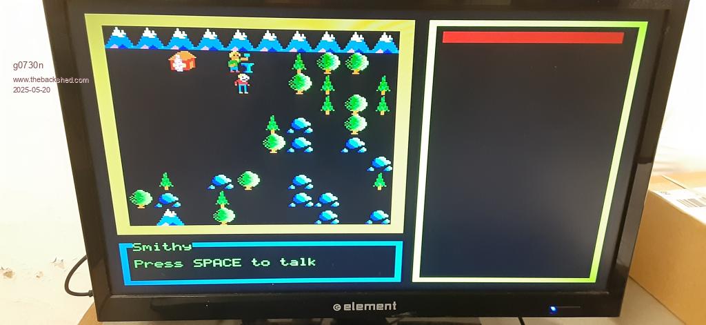

g0730n
Joined: 14/05/2025
Posts: 18
Posted: 12:52am 20 May 2025
Awesome thanks guys lots of great info!
i usually use paint.net while on windows, martin the link you provided is very helpful for going that route.
so far I have created 36 16x16 sprites in this game I am making, using your mmbasic sprite editor. I may make a few more but i have pretty much done all tiles, enemies, npc's and items that will be used in game. i dont plan on animating anything at this point.
