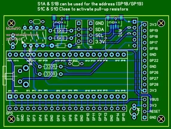

The QWIIC connectors are optional and are powered from the Pico's supply, which also feeds the pullups. The two 4-pin I2C headers are connected to the remote device's supply. The Pico's 3V3 is fed from a diode from the remote supply so it will be powered by either the USB socket or remotely. This isn't really ideal as there will be volt drop from the external source but I didn't want to have to squeeze a mosfet in!
EDIT:
Still in design. I've just squeezed a CR1220 on board so RTCs with dead batteries can be reused. I don't like throwing them away.  :)  There's also a solder blob link to disconnect the remote 3V3 supply. That might be useful in some cases, like where the supply is from a low current source.
Edited 2025-07-07 02:02 by Mixtel90

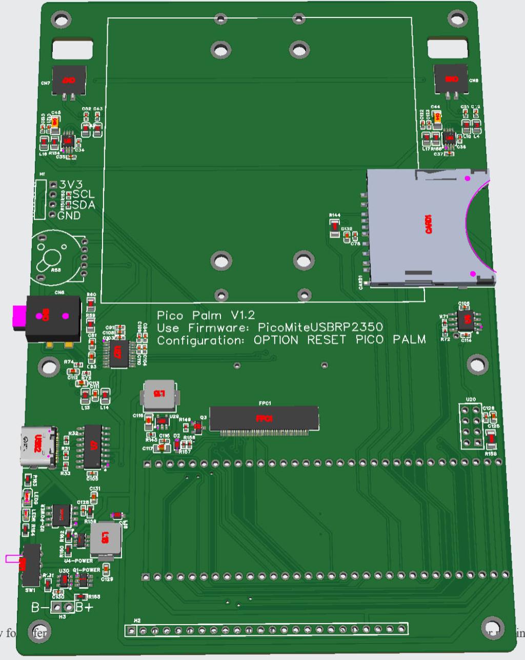

Here is the new layout and revised schematic
87069bec-9ffb-4649-896d-5216e80dc431.pdf
Edited 2025-07-11 03:53 by matherp
Posts: 2998
Posted: 06:22pm 10 Jul 2025
Looking good there Peter!
Observations (take them, or leave them!).
1: I assume that is still and ESP8266 (from the shape of the connector (schematic quotes ESP32)
2:  to make it easier for the user to adjust the volume when the stereo output (CN6) is in use, ideally the volume control and stereo-out connector should switch positions
3: would it be better the power switch is moved nearer to the ‘top’ of the PCB  I.e. out of the way, rather than right at the bottom where it is more likely to be accidentally pressed
Looking really nice with a great choice of connected parts……
Posts: 12176
Posted: 06:46pm 10 Jul 2025
1: just the legend wrong - thanks - also will be on the bottom of the board
2: Agree but from a layout perspective it wo4rks better keeping the audio signals clean so I'll leave it where it is.
3: Likewise, logically agree but from a layout perspective it works much better as is switching the 5V line from the boost circuit.

The big changes from the original will be:
Keyboard scanned by the RP2350 (6x12 scan matrix)
I2S audio using PIO to generate the I2S output
DS3231 RTC on board.
True memory mapped 8Mb PSRAM
In addition, I've developed a RGB332 framebuffer based driver for the ST7796S display with the screen updates done on the second processor. This gives a huge performance improvement over the current driver.
All my code will be available on https://github.com/UKTailwind/PicoMiteAllVersions so feel free to copy the various drivers. I won't update the github until I've tested on the new PCB.
I'll be interested to try your Forth port. I used Forth many many years ago but will need to re-learn  to even get started.
