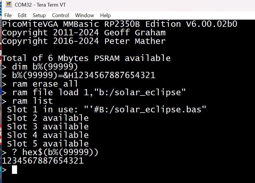

Ram slots in memory (just like flash slots) but with the ability to load and run programs from within another program with or without the variable space being preserved.
NB: 6.00.02 will also have a CHAIN command for all versions
