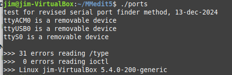

Posted: 01:04am 13 Dec 2024
Looks correct on Linux Mint running in a VM
One Picomite and one CH340
Edited 2024-12-13 11:06 by TassyJim

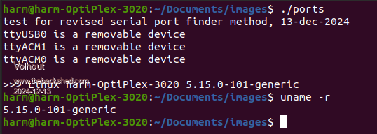

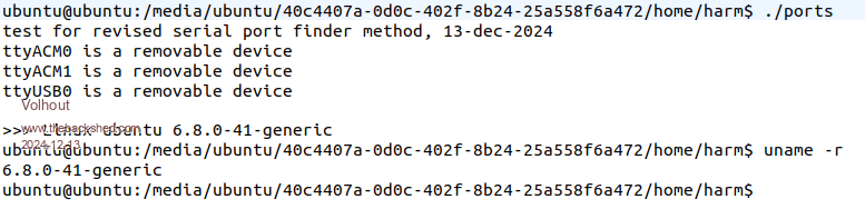

Posted: 07:38am 13 Dec 2024
Robert,
I could try to to a test on Ubuntu 24.04 as live distro ? (not installed) ? Not sure if that will work. Connected FTDI RS232 cable, arduino UNO, PicoMite
Ubuntu 20.04
Ubuntu 24.04 live
Edited 2024-12-13 18:32 by Volhout
