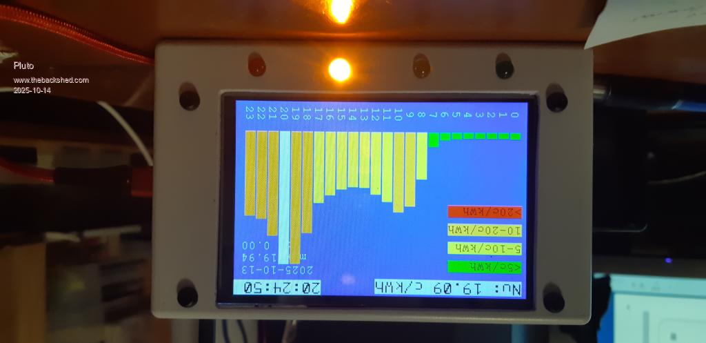

Posted: 06:31pm 13 Oct 2025
The electricityprice-meter from last year has been in constant operation since Jan 2025. Placed in the kitchen it gives a good and easy overwiew of cheap and expensive hours. Better to heat the sauna when close to 0 c/kWh than at 60 c/kWh.
(Don't understand why is it upside down. Tried to turn it and still...
To make it a bit more complicated the tariffs are now changing each 15 minute.
Got some new Pico 2W and started to work on a new meter.
The problem today is that I am not able to receive the full datastring for all of the 96 15minutes data without errors. I had to divide the data into 2 12hour parts, which are received by 2 separate WEB TCP CLIENT REQUEST (which is not a problem).
The stringlenght for 12h is LLEN(buff%())=4493 and 4470.
I have now set the buffer to Dim buff%(4096*4/8), which should be enough.
My question is: What is the max lenght of data that WEBmite's buffer can handle?
At best I got about 90 of the 96 datapoints in one shot. The error when trying to get all points was some extra nonsence "eg. 1 10c" in the received textstring. That ruined the Json$ parsing of the data.
