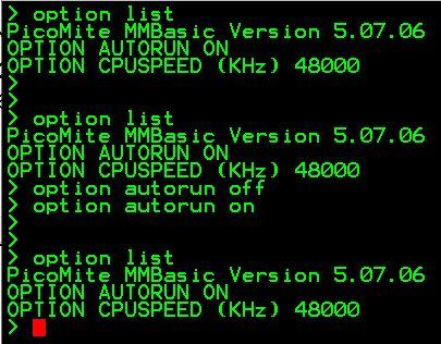

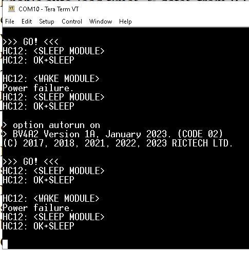

This is odd.  I cannot make the PM run the current code, even though I have set the option.  I tried switching it back off again, then setting it on once more, but the program won't start.
I am dropped at the command prompt, which works fine when I connect to it, and OPTION LIST shows that it should be working, but it never starts running the code.
I can start it manually with RUN, but that is no good, I need it to start at power-up as the USB won't be connected.
Anyone else seen this problem?
The code is sitting in flash memory, not in any of the slots.
Perhaps I should try saving it into a slot, but I did not think you needed to do that on the PM - perhaps I am wrong.

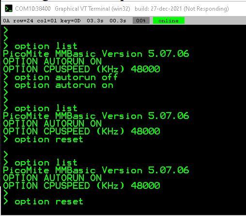

EDIT: It's getting worse.

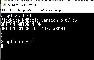

OPTION RESET crashes the PM and GFXterm.  I will try again under TeraTerm, but the only way out of this is to reset the PM itself, at which point, the options are still there.  OPTION RESET didn't work, in other words.
I'll see if I can do the option reset inside TeraTerm.

Nope, OPTION RESET crashes the PM in TT as well, so I am unable to reset to defaults.
TT's menus etc still work, but you just can't do anything until you press reset on the PM module, at which point we're back to where we were before.

EDIT: Seems to be something to do with setting the CPUSPEED to 48MHz.  Issued the command OPTION CPUSPEED 133000, PM then rebooted as expected.  OPTION RESET then worked.  NEW, then AUTOSAVE the code back to it again.  OPTION AUTORUN ON, and eveything is working as expected.
