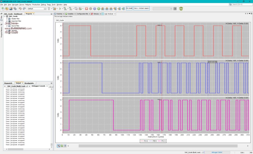

I have just written a short program that exercises MOVIW FSR--/++ without any interrupts, subroutines, and minimal initialisation. Straight line code if you will.
It runs from the internal oscillator at 32MHz, so needs no external components at all.
It ran the same at 4MHz and 16MHz too.
MOVIW Test.zip
Enigmatically, it behaves to spec.
The code reads a toggling table of just 4 o/p states in a table in GPR Bank 0, running up and down the table manually.
There are 3 o/ps :-
RA3 - 'scope trigger,
RB3 - a straight switched output,
RC3 - a copy of RB3, but using MOVIW recovered data from Bank 0.
Expected waveforms are shown in the file.

Like I said before, your original ISR code using FSR0++ and FSR0-- works fine.  I believe the issue you are having with that code is a setup problem with the DAC (or the interrupt is really not firing after the 1st time)... there is some oddity with PWM5IF.  Your new example code works perfectly and generates the expected waveforms as you can see with the Logic Analyzer (built into MPLAB-X).
Edited 2023-02-06 17:36 by JimDrew
Bowden_P
Joined: 20/03/2019
Posts: 176
Posted: 02:09am 07 Feb 2023
Hi Jim,
Oh dear-oh dear !! A salutory lesson indeed in understanding the datasheet....
It all comes down to automatic context saving/restoring and those "shadow" registers in Bank 31, and what they do.
On branching to the ISR the FSR's are saved in the shadow registers, and restored on exiting. My program incremented or decremented FSR0 in the ISR for the next time the ISR was called. Problem was this inc./dec. was nulled on exit by the automatic restoration from the shadow register - hence next interrupt call the FSR0 hadn't changed, so the value extracted from the sample table was always the same - no output waveform.
It's all very logical of course.
The cure is to increment or decrement the FSR0 shadow register before leaving the ISR.
Thanks to all contributors to this thread - and I hope my stupid miss-understanding will be of some benefit.
At least Jim you will have some on-chip op. amps to play with. Many thanks for all your  time and effort too.
With best regards, Paul.
Edited 2023-02-07 12:12 by Bowden_P
Nothing so constant as change.

        7.5K   |   7.5k       16 |     \          |
I/p  o--\/\/\/--o--\/\/\/--o------| +     \        |
                          |      |         \ 17   |
DAC samples 8-248          |      |   OPA3   |-----o---o
                  10nF  ----- 18 |       /        |
                          |    |         22K      |
                          |    o--------\/\/\/----|
                          |    \ 39K
Gnd. o---------------------o----o------------------------o
This Butterworth filter has an Fcuttof of about 2.2KHz, used to filter the DAC output of 500Hz.
Fundamental of the DAC1 o/p samples is 10KHz. ( 20 x 500Hz.)
The Fixed Voltage Reference O/p 2 used for the DAC is set to x2, = 2.048V o/p, with the 11 sample data going from
lowest d'008' to d'248' highest. These values are only put into DAC1REFH<7:0>, DAC1REFL<7:6> is not addressed, effectively
rendering the 10-bit DAC as 8-bit.
These 11 samples give a sine wave when L.P. filtered :-
Degrees : -90 -72 -54 -36 -18   0   +18  +36  +54  +72  +90
DAC 1   :   8  14  31  57  91  128  165  199  225  242  248
My apologies for the data error in the.ini file in the last full program .zip.
Here is the correct - and working - code. The device oscillator will require a 8MHz crystal on OSC1/OSC2, RA6/RA7, pins 10 and 9.
The device Vdd = 3.3V.

Hey, thanks for this info!  I was curious how you were able to wire this as a traditional op-amp. I guess it is just like having one externally.
Is the internal oscillator not stable enough for this?

Hi Jim,
Yes, it's really handy to be able to use these on-chip components independently if required.
The internal oscillator would be fine for most uses at +/-2% accuracy. I have used a crystal just to improve on this - to about 0.003%. ( Its only an inexpensive crystal at 30 p.p.m.)
