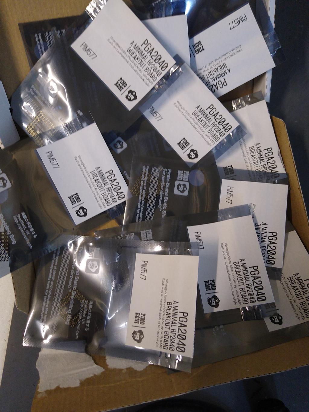

I would take a clone over the Pico every time, just to avoid the godawful micro USB.
I have the Lilygo with the ESP32 and display but my favourite is the unadulterated Pimoroni PGA-2040.
Here, my USB connector is a 4-pin Phoenix-style (5.08mm) which actually looks/feels right for the factory environment.

Posted: 12:09pm 21 Aug 2022
@Grogster
I'm kinda committed...
