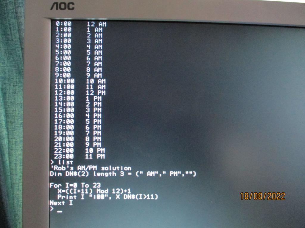

Posted: 12:09pm 17 Aug 2022
or...
Dim DN$(2) length 2 = ("am", "pm", "")
For I=0 To 23                ' or "To 24 Step 3" to fit on a single screen
  X=((I+11) Mod 12)+1
  Print I "oo", X DN$(I>11)
Next I
been doing it this way since 1986!
rob   :-)
Edited 2022-08-17 22:23 by robert.rozee
Posts: 6254
Posted: 01:45pm 17 Aug 2022
Robert,
You are a wizard, that is by far the most compact solution I have seen.
X=((I+11) Mod 12)+1
Print X DN$(I>11)
Edited 2022-08-17 23:48 by Volhout
Posts: 10109
Posted: 01:45am 18 Aug 2022
Wow!
Lots of different solutions!
I will HAVE to try Rob's solution out now! (substituting my HR for his I variable)
It is so small and elegant!
I will link to this thread when I edit the FOTS page, saying there are more examples of doing it here.
