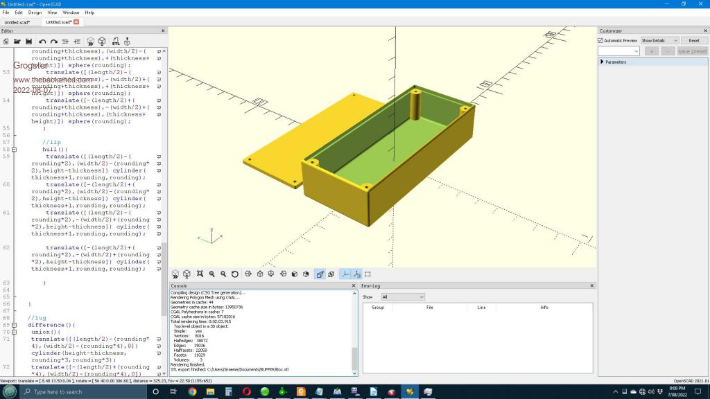

Posted: 08:10am 07 Aug 2022
Thanks very much Ian, for your code examples.  They import and work just fine.  The 2nd code you posted for the box, produced a very recognizable result in the form of a small project case with a matching lid:
This gives me a basic project box and code, that I can play about with, just to learn how to do things, which I think will be helpful for me to learn the program a bit better.

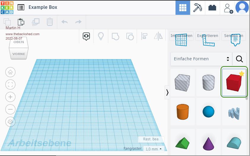

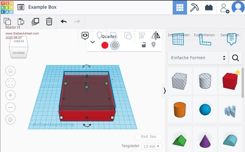

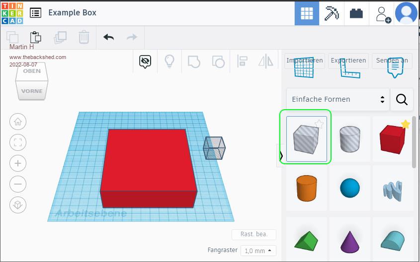

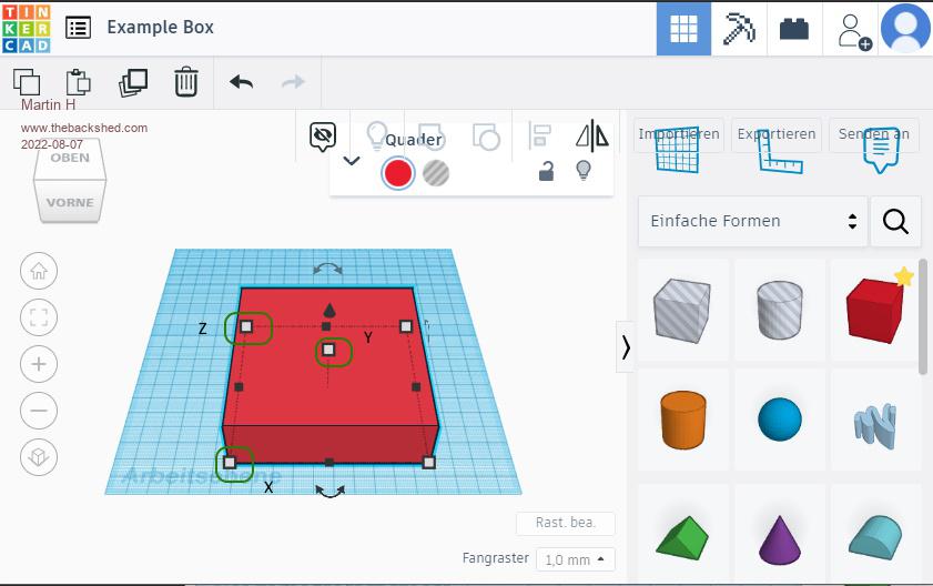

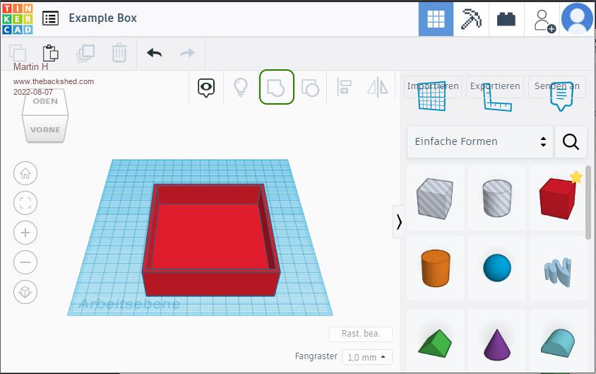

Posted: 10:25am 07 Aug 2022
simple Example Box in Tinkercad
Use the Box Shape
Place and resize it as you whish
select the shape to cut
Resize it and place it inside the Box
merge both Shapes to one
there is the Box.
Which can be downloaded as .obj, .stl, .gbl or .svg File
imho. for simple Shapes an easy way to construct.
