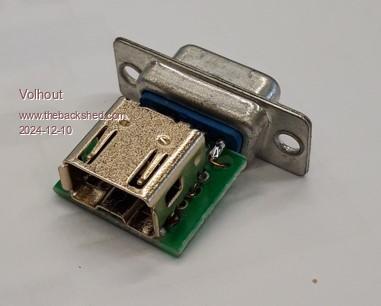

But these are nice. Made a small convertor using GP26/27 for I2C.
Adapter for PicoGameVGA port A.

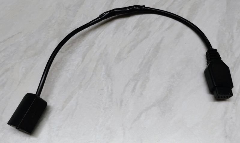

Much neater than mine. I spliced two controller extension cables together, made a mess of the heat shrink and ended up bodging with insulation tape. IIRC it's not a thing of beauty inside either .

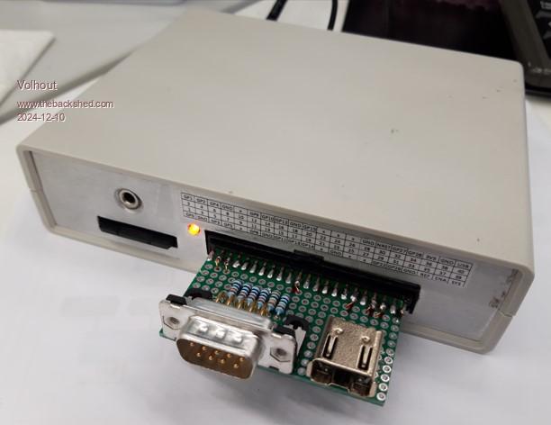

Finally got rid of the "aligator clips" nunchuck/classic connection. PicoGameVGA port A, and nunchuck connected to system I2C bus.

I'm not using the linear reg to reduce noise, just to get GP23 as a general purpose input. I ran out of GPIO pins. :)  The original design did use the switcher but then I realised that I'd missed a pin. I could have sacrificed the joystick facility on Port A, but I didn't want to as I've already lost it on Port B. I considered it more important to have both I2C ports available as they are of more use. It's all compromises. :)
That's a very neat little board. :)
