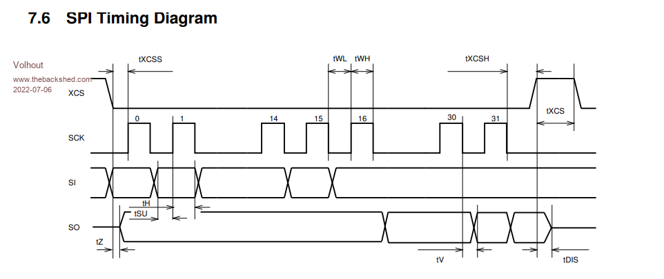

Not sure, but I expect the SPI mode should be mode 1 (active clock is HIGH).

I suspect you might need to run SPI in Mode 1.
SPI frequency should not be higher than CLK1/7. Better a bit lower so probably no higher than about 3MHz as the minimum internal clock (CLK1) is 24MHz.
