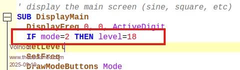

If you do not want to solder a new opamp....
The problem is that in square wave mode the input of the opamp is driven with 2.5V input signal (211/256*3.3V), and the opamp has a gain of 6x (the 9833 sine and triange wave signals are small signals, the square wave is huge (rail to rail).
So the opamp input is over saturated, causing this type of distortion. If you (software) limit the input signal to the opamp in square wave mode, the opamp amplifies linear. I have managed that by adding 1 line in the program to send a different setting to the attenuator, while keeping the display at 100%).
You will not see a perfect square wave, since the opamp operates in linear mode, and this opamp (AD8051) has a small signal bandwidth of 110/6=18MHz. Large signal bandwidth is typically less. To get a better square wave, we need a faster opamp. i.e. a OPA356. But this may be good enough for many.

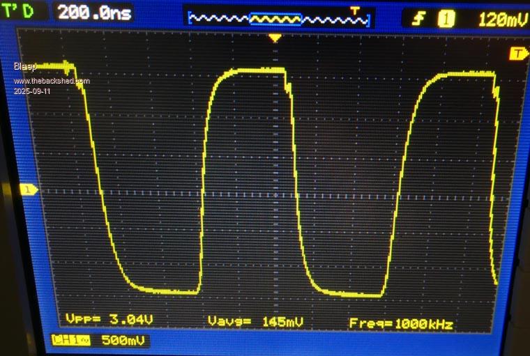

Posted: 08:16pm 10 Sep 2025
Hi Harm,
I have modified as you suggested and it definately makes the Square wave better, presumably it was being over driven before. I changed my level to 18, because it gave me a 3V p/p square wave, which is the same as the Sine wave at 100%.
 If Mode<>LMode Then
  LMode=Mode
  If Mode=2 Then
   LLevel=Level
   Level=18
  Else
   Level=LLevel
  EndIf
 EndIf

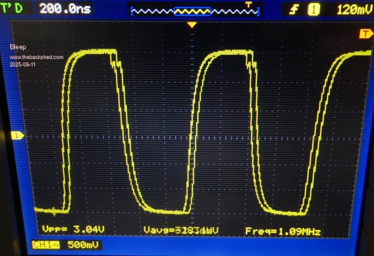

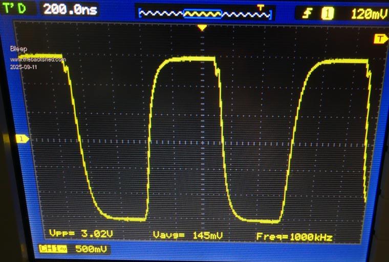

I do find there is a strange 'jitter' on the square wave, for want of a better word, I assume it is to do with the crystal divider, though I still get a very slow change, about every second even if I select 1MHz, which I would think should be a perfect devisor frequency. If you look at the following 2 images, taken about 1 second apart, you can see that the falling edge moves, the rising edge is steady.
This image is when I select 1.1MHz, which would be a devisor problem.
Otherwise the Square is definately an improvement, Thanks. :-)
Regards, Kevin.
Posts: 6253
Posted: 07:19am 11 Sep 2025
Hi Kevin,
The "jitter" is exactly what I saw (the numerical divider alternating between 24 and 25 (or 25 and 26). However, this seems absent in the sine and triangle (the DDS signals) waveform.
I copied your solution on the software. Maybe Geoff can apply that minor code change also to the code on his web page.
