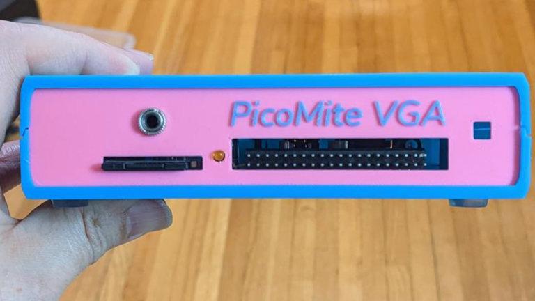

scruss
Joined: 20/09/2021
Posts: 116
Posted: 03:37am 07 Jan 2023
If I were a person who knew what they were doing I'd probably not need to ask this, but:
Will a PS/2 keyboard only work if you're powering from USB? My two keyboards only work if they get 5 V power from USB. If I use a power adapter through the 3.3 V LDO regulator, neither of them do anything.
Otherwise, my colourful PicoMite VGA works great.
Thanks!

Posts: 9329
Posted: 10:24am 07 Jan 2023
I have two or three PS2 keyboards that are fine on 3V3. The only thing I notice is that the LEDs are slightly dimmer!. However, I design my boards to power the keyboard from 5V and include some sort of level shifting for the PicoMite. It's not worth doing otherwise.
That looks so cool, scruss... and no clash with the purple PCB at all. LOL!
scruss
Joined: 20/09/2021
Posts: 116
Posted: 08:07pm 07 Jan 2023
Ah, thanks. Looks like this one is going to be USB powered from now on. Just as well, as I can't source any other 3.3 V regulators affordably.
