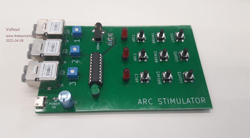

My latest (small) project: a 3 channel ARC stimulator.
In mains distribution circuit breakers are used to disconnect parts of the grid. When disconnecting a uncontrolled load, these circuit breakers can arc (like a welding arc). Prolonged arcing is destructive. That is why some installations check for the arcing during switching.
Generally these installations use optical fiber loops (glass and plastic are superb isolators) without any coating. So external light can pass from the circuit breaker into the fiber, where is is checked by a light detector.
The detectors can check the fiber existence by sending a light pulse into one end, and checking the response at the other end, a so called heart beat.
To test the detector, this test circuit can be connected to 3 of these fiber loops, and simulate a controlled fiber break, send a controlled light level, and simulate background light entering the system (someone opening a installation cabinet in bright daylight).
Since I use a single microcontroller to operate 3 completely independent circuits, the simplest solution was to use a picaxe 20M2 that can do simple multitasking,  and use 7 tasks of the 8 available. Coding this in a picomite is not as straightforward (dangerous to say, I am sure many of you will know how to do it, but I took the simple way out for this project).
The code is not optimized, but it simply works.
The ARC pulse generated is currently 10ms (1 half cycle at 50Hz) but the software uses the picaxe "pulseout" command, so potentially it can be as fast as 10us. The unit I have to test can handle these short ARC pulses.
The code (beta-1)

Too bad the indenting is again f*cked up.

At first glance, I am wondering why all the gosubs?
Yes, the PicoMite would have no problem with this by using a state-machine for each task and passive delays instead of "pause". State machines are easy to debug because the code is sequential.
I naively believed that I invented this technique back in my early days of programming  . Many years later, I read an article about "state machine programming"...Hey wait a minute!
This is exactly what I do with my Mites
Craig

I’m interested why you choose a Picaxe 20M2 over the 28 pin Micromite. Not trying to start a war - just curious.
Posts: 6254
Posted: 10:25pm 08 Apr 2022
In essence there are 9 functions, in 6 groups. By using 6 tasks , I can write 6 indepenent pieces of code that can operate independently. In example each of the 6 tasks uses a simple pause statement. In picaxe basic these operate completely independent. So I can start a pause 7000 in task4 while a pause 7000 is half way in task 5. They dont have to wait for other pauses to finish. I am sure that can be done in micromite, but not that simple.
I asked Geoff if he could add multitasking to MMBasic, but that was very complex. And it would require resources, memory, as well as cpu power.

Hi Al18,
Let me try to explain the benefit of multitasking in development of simple code.
In my application I have a keyboard scan (task0) that scans a matrix of keys, and delivers a key value in a global variable.
Each of the other tasks wait's until if recognises it's assigned key, acknowledges it, and then executes a function that is related to that key value.
By this architecture, each of the functions can be executed simultaneously. Press key 1, task 1 recognises the key, acknowledges it, and executes the function. Even if this function lasts 1 minute, key scan routine will deliver a new key function when I press the second key, and task 2 (or 3 or 4) recognises the key and starts executing. So the keys drive virtually independed functions.
Technically this is also possible in a single tasking environment, but then you need some kind of sequencer that can start and stop individual functions based on timer values.
There are some restrictions to the multitasking in the pickaxe 20M2 pickaxe (as for any multitasking system)
- avoid shared resources (the tasks cannot independently change the same GPIO pin, or use the same I2C bus, unless special precautions are taken
- the 20M2 uses hard scheduling of the tasks, and to minimise the impact that has on the performance, they change the CPU clock in multitasking. When a standard pickaxe runs at 4MHz, in multitasking it runs at 32MHz (8 tasks, 4 MHz each). Not all microcontrollers can do that (a 125MHz pico mite would have to run at 1GHz).
- the pickaxe only uses global variables in basic (the interpreter will have 8 individual stacks, but the user is unaware) to avoid explosive memory use.
For this small ARC test system this was no limitation. And actually, I also used 4 tasks in an earlier project: an alarm clock that was based on a pickaxe 18M2. I actually like programming in multiple tasks, since I can focus on the algorithms that are needed to do the ask, and not worry about the interaction between them. The interaction is often more complicated to deal with than the actual algorithm.
Geoff and Peter already have implemented some function in MMBasic in the background, that is also a form of multitasking. Only in these cases specific to a function or command. Some examples are:
- serial ports: you write to a buffer, and in the background these are send to the serial port
- ADC command: You give it the command to gather X samples at Y speed, and get a message when it is done
And there will be others, mostly hardware related, that give authority back to the basic interpreter, before the actual work is finalised.
Tinine als uses multitasking a lot (the parallax has multiple cores, so that is real multitasking...)
I hope this explains my choice for the 20M2
Edited 2022-04-10 00:19 by Volhout

  Tinine said  At first glance, I am wondering why all the gosubs?
Craig
This is my limited knowledge of the pickaxe basic language.
I wanted an abstraction layer between hardware and software. Something that translates LED_ON to a certain GPIO.
The way I know to do that was either macro's or subroutines.
In the final version, using the 20M2 it happens that all subroutines ended up being single commands, so it would have been more compact to work with #define's or symbols. But an earlier version running on a different chip had some subroutines that existed of multiple lines.
I may still do this change for the final version
Edited 2022-04-10 00:29 by Volhout
