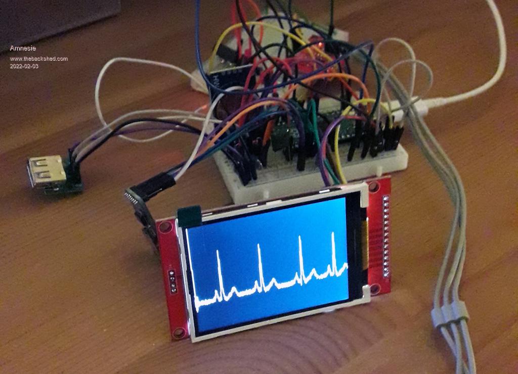

...well kind of! Short story: After building the Colour Maximite 2, the PicoMite has waaay more potenital in my opinion, because you can source all the parts for cheap in every country.
I often felt my heart does some extra beats (premature ventricular contractions)I thought I can visualize those and build an ECG. I did this in the past with an Arduino, but now is the time to put the picoMite to the test! It is really amazing how simple
you can get a primitive ECG programmed in BASIC.
No extra beats on this image :) And ignore the messy work, I already designed a PCB which is on its way from JLC.

Yes it is way from perfect, in fact this was just a quick test.
I set it up with interrupts for later digital filters (notch filter to get rid of movements and 50hz noise). Also I plan to write the data to the SD card to analyze it with proper ECG software. I just want to thank all people involved in this great conversion to the RaspberryPi Pico! As soon as I implemented digital filters I post my progress.

What have you done for sensors - I guess that they are the grey cables bottom right of the picture?

Yes, it is the well known AD8232 sensor for just 3 euro in Germany, which really works great. I am sure it is possible to build a lot of features in this BASIC program. At first I will concentrate on filtering noise, but this should be no problem since there is enough cpu power, it even works on an arduino I just have to port it from C to BASIC language. I am a little bit new to this, so it will be fun as well :)
Also planned is SD card output and audio warnings, glad that Peter fixed the wav audio skipping bug in the firmware.

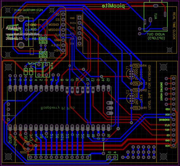

This is my designed PCB for general purpose projects for the picoMite.. if everythings works I can upload the gerbers if there is interest.
Some features like RTC, KEYBOARD, LCD, SDCARD etc.. are on board. I am not using the onboard SD socket of the display because it is bad quality... The Adafruit breakouts are way better.

Neat indeed. Please do post the gerbers (or wait if you think you have further refinements). And please post a link to your sensors. Which PCB design software did you use?
Maybe run MISO with an inline 680R resistor so that a larger SPI 480x320 ILI9488 may be used (although it could be used with MISO not connected as long as BLIT READ or similar isn't wanted--or, perhaps more importantly for this application, SAVE IMAGE).

Thank you lizby for your advice! I am using easyEDA as "software".
