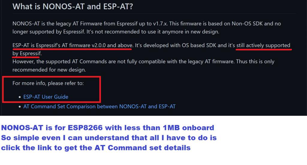

I really don't understand why people don't acually check things before complaining.
Here it is just press the link to see the AT COMMAND SET  as used in the firmware as stated ON the github page
Posted: 01:21pm 26 Jan 2022
  Quote  I really don't understand why people don't actually check things before complaining.
That is the official list of all AT commands. What is implemented in a particular firmware depends on what is selected in the build
Posts: 9329
Posted: 01:22pm 26 Jan 2022
Sorry, lew, I missed that on GitHub. Have bought a ticket to SpecSavers....
I probably didn't consider that a "User guide" might actually be the command list.
There's a lot more info in the binaries zips, but It's rather generic as the 8266 ones still contain the ESP32 commands and you have to work round them. :)
Edited 2022-01-26 23:32 by Mixtel90

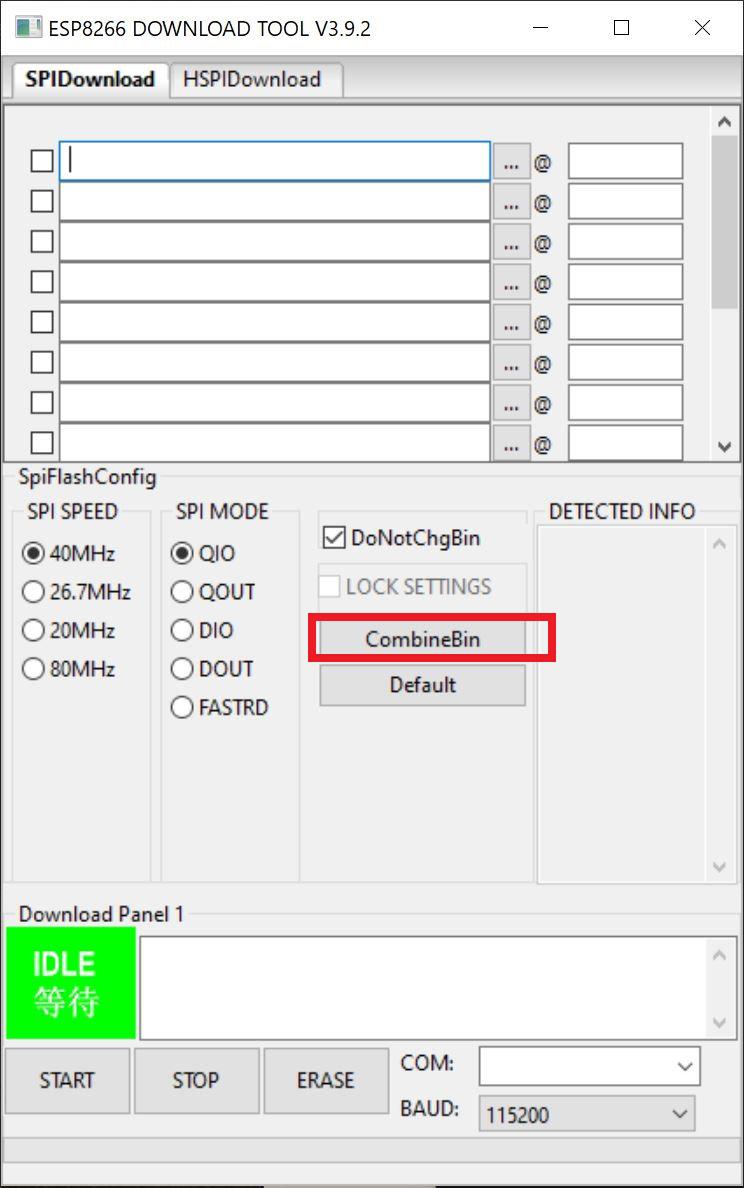

Posted: 05:26pm 26 Jan 2022
The links I posted for the ESP8266 (this link) and ESP8266-12 binaries (this link)  are just one .bin file you flash
although if  you have the orginal 8266 with 512k then yes it will have to be compiled from link at the bottom of the post on the previous page  this link
Complete step by step instructions on how to Restore or Upgrade Firmware on ESP8266 (ESP-01) Module (for use with the 512K module where you have more than 1 binary to flash) Restore-or-Upgrade-Firmware-on-ESP8266-ESP-01-Modu.pdf
EDIT: If ANYONE has an ESP8266-01 the one with 8 pins and the 512K flash then could you please use this flasher along with the instructions in the PFD and when you get to the flash image load the binaries and then click the COMBINE button to make 1 binary you can then share with the forum to make it simpler to flash?
I would have done this myself but I cannot find an ESP8266 or flasher
Edited 2022-01-27 03:48 by lew247
