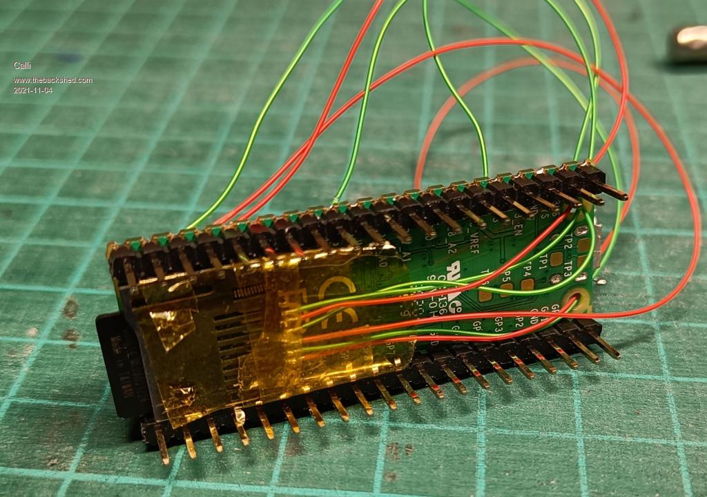

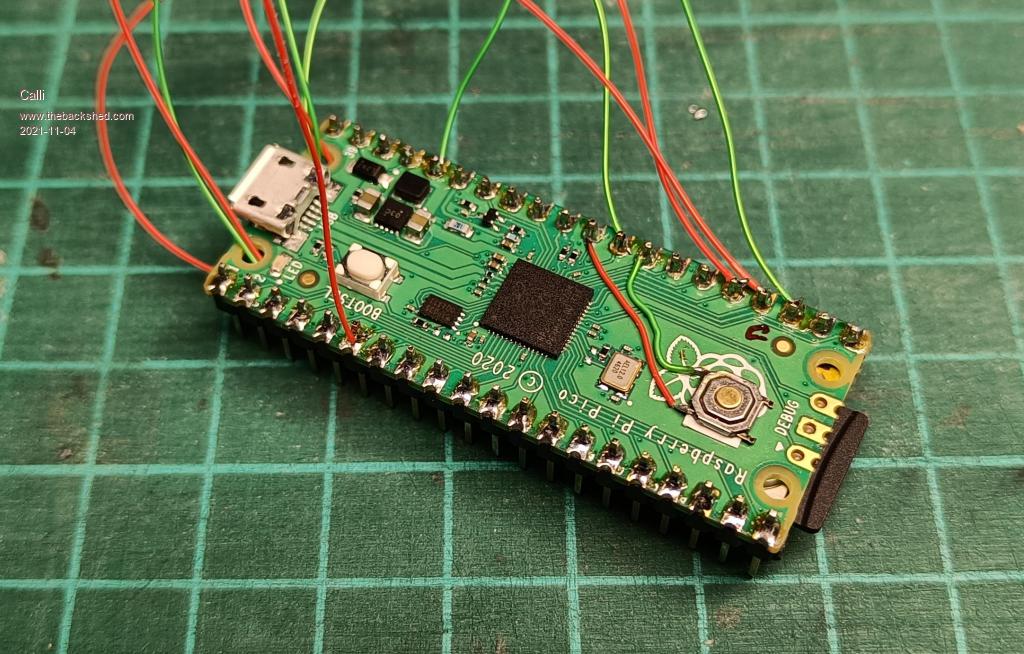

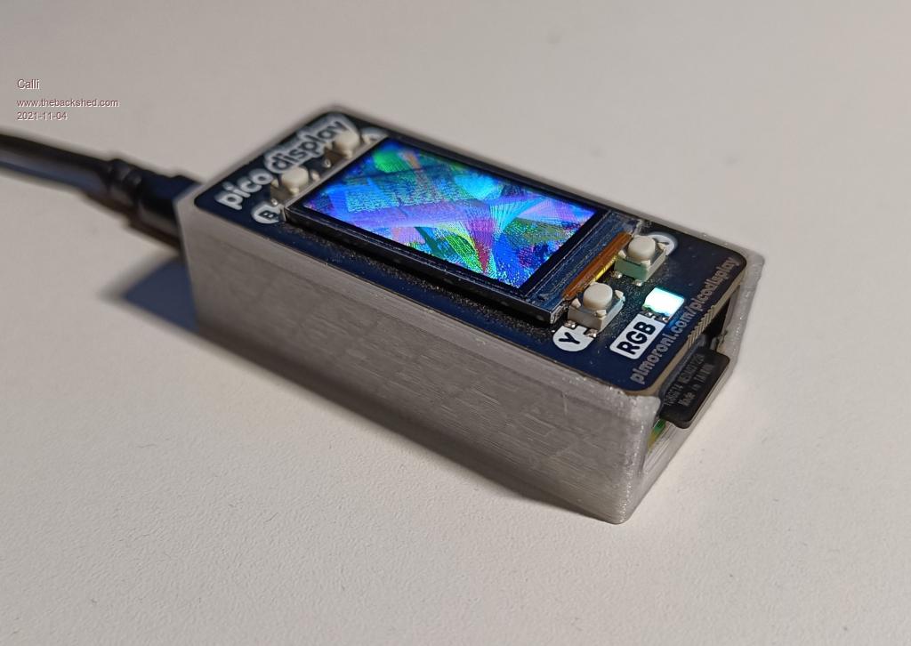

I bodged a uSD-Slot onto a Pico which carries a Picodisplay.
Super cute little device with four switches and a RGB-led.
I use these options:
OPTION SDCARD GP22
OPTION SYSTEM SPI GP18,GP19,GP4
OPTION LCDPANEL ST7789_135, LANDSCAPE,GP16,GP2,GP17
The wires were shortened after a first test! Yes that's a reset-switch.
Best,
Carsten
Edited 2021-11-04 04:37 by Calli
karlelch
Joined: 30/10/2014
Posts: 368
Posted: 10:52am 04 Nov 2021
Cute - only bluetooth is missing ;-)
Calli
Joined: 20/10/2021
Posts: 74
Posted: 04:31pm 04 Nov 2021
Maybe with Nano Connect :)
