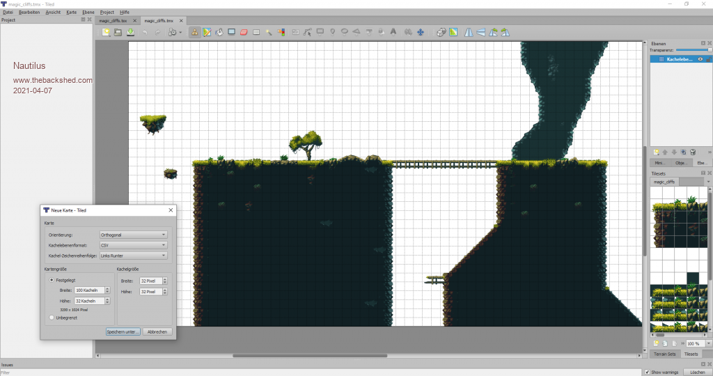

  epsilon said  Are you using a level editor to create the tilemap.csv?
Yes - the TILED map editor is your friend   ( https://www.mapeditor.org/ )
MauroXavier
Joined: 06/03/2016
Location: Brazil
Posts: 307
Posted: 07:37pm 06 Apr 2021
Nautilus, very clever idea, I will get a look at this software. Thanks for the tip!
Meanwhile, I suffered developing a map editor only to have the experience creating maps directly on the CMM2... But for sure this isn't the most recommendable experience to speed up the development of a 2D game.
Now I'm seriously thinking about quit making another map editor to the INTO THE DARKNESS game.

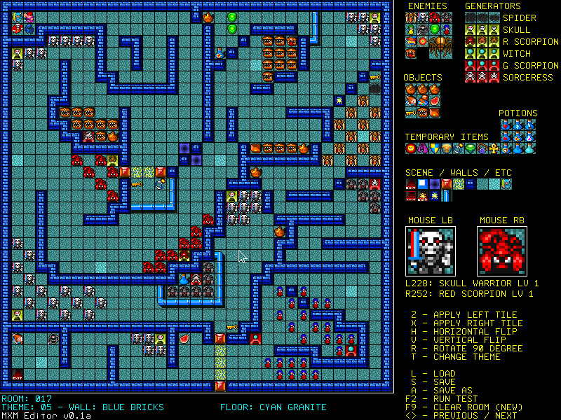

I have a suggestion to speed up your rendering, change your engine to make only one full refresh at the beginning, and after make it refresh only a line or column on the sides of the screen as it moves. If you use a parallax background, you can store the main tiled screen on another page to join it in the background after, this way you don't need to rewrite all the scene again too.

  MauroXavier said  I have a suggestion to speed up your rendering, change your engine to make only one full refresh at the beginning, and after make it refresh only a line or column on the sides of the screen as it moves.
at the beginning i wanted to realize it exactly like that. but i decided against it, because i really want to have tile animation (lava falls !!!       )
but i keep the idea in my mind (maybe a special version for a special game) ...

  Nautilus said  at the beginning i wanted to realize it exactly like that. but i decided against it, because i really want to have tile animation (lava falls !!!       )
You can refresh only animated tiles on the screen, not all tiles in a single refresh.
I made it in the MAZE OF CHAOS (aka Gauntlet clone) to animate some objects and the speed gain was very noticeable. It would impossible to keep four players running at the same time if I chose to refresh all tiles in each game loop.
In your case, I believe it would be a good way as you are working in a higher resolution than my games.
