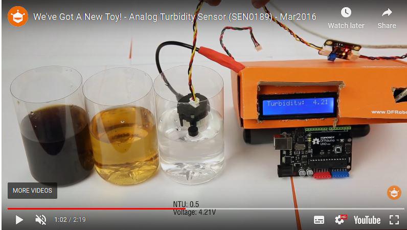

Does anyone have any experience in measuring the clarity of water with a turbidity sensor salvaged from a dishwasher or washing machine.  These can be bought new with the necessary ADC/trim pot via https://www.amazon.co.uk/DFRobot-Gravity-Analog-Turbidity-Arduino/dp/B075T3CVH6/ref=sr_1_5?dchild=1&keywords=turbidity+sensor&qid=1612780108&sr=8-5
Was wondering if any fish keepers or brewers had rigged one up and if they offer anything "more" than a white LED / photo resistor?
My use case would be a desktop aquarium into which I am wiring temperature and pH.

I don't have a downer on this device, but I am even more convinced this will not provide what is needed in the tank.
Looking at Wikipedia regarding NTU, the very first picture tells pretty much all you need to know. NTU of 5 is almost still clear water and 50 is unmistakably obvious to the naked eye. Taking these two values to fig 6 and both would barely register voltage-wise and be quite difficult to separate from fluctuations in ADC readings:
0NTU  =3.9994V
5NTU  =3.9954V
50NTU =3.9594V
Just 36mV between barely noticeable versus quite milky and I figure you'd be well below 50NTU in practice
Something else that occurred, things suspended in aquarium water tend to get a bio-film coating of slime - bacteria and algae so the efficacy will drop over time leading to false positives. Even with cleaning I reckon your base-level will drift and the thing will need calibrating reasonably often.
Of course all this depends on how serious-an-application... for a bit of fun it will demonstrate the principals.
Oh, and there is the 3.3V input to the ADC thing, so you'd need a potential divider on the output of this sensor.

You're right - I hadn't got round to considering the range of the NTU -- even when the tank is "dirty" it will be around 5NTU -- so the sensor are unlikely to be sensitive enough.   And the biofilm will kill off that sensitivity eventually.
That said, for 20UKP I think I'll still have a look and see if I can replicate the IOP paper from @lew247

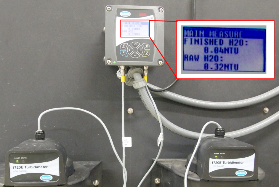

last word, that pic on WikiP for a potable water filter shows the following in/out NTU. (big boys toys Turbidimeter 1720E - yours  for a cool 300 sovs)
