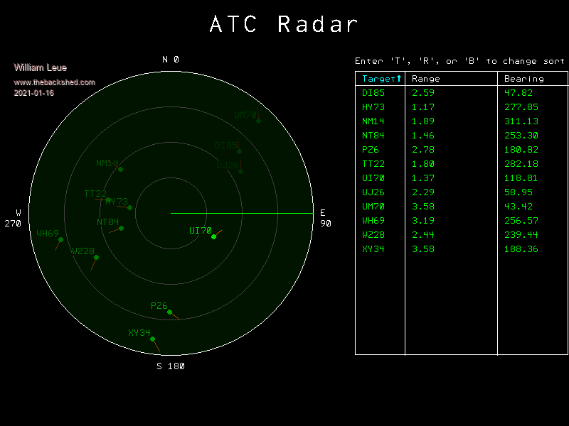

I have been in a goofy mood and came up with this little program. It sort-of simulates an old analog radar display along with a table of ranges and bearings for each target. All the target info is randomly generated and will keep going forever, or until you get bored. A README file has more details.

I should mention that this program brings out some bad CMM2 behavior. I use page blitting from 1 to 0 (with sync) to avoid flicker. But I think that the blit is taking too much time, so the screen jitters at times and sometimes just blanks out for a second or two.

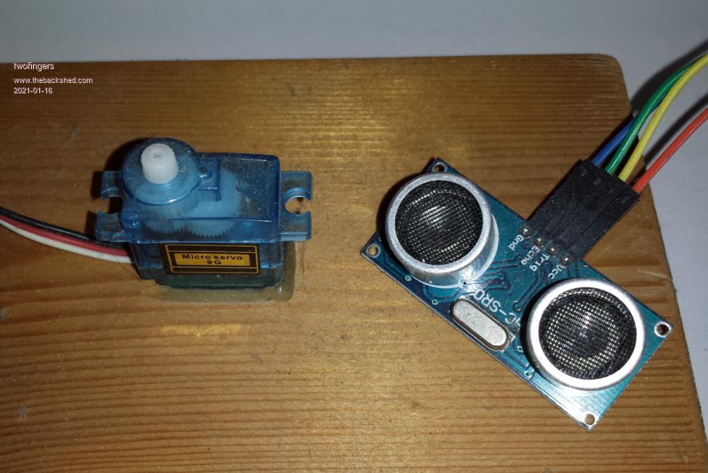

Maybe you (or someone?) can add a cheap servo and ultrasonic module to get real data for a 120* "SODAR"?

Here is version 1.1 of the ATC radar simulation.
Notes:
1. Added a small delay after each page copy. It helps a little with video glitches on my CMM2.
2. Asks the user for the number of targets that should be shown at game start. More targets means a slower sweep around the screen. Users can add targets during the game by pressing the UP arrow, but not delete them.
3. Adds a few command hints on the screen.
-Bill

The speed is slow because of several reasons. To really speed it up would require a major rewrite.
The main reasons are:
1. The page clear of Page 1 at the start. This could be eliminated if a lot of other stuff is changed.
2. Because of the page clear, the need to redraw ALL the elements of the screen on each update, which happens every time the sweep moves by 1 degree.
3. Because of trying to simulate the exponential dimming of phosphor on an analogue screen, each of the targets gets redraw on every update. If you eliminate the dimming, then targets only need to be redrawn when their position changes, which is only once per target on each full revolution of the sweep. Of course, you have to eliminate the page clear first.
4. The table at the right is fully redrawn every update. It would be more economical if only the data that changes gets redrawn; basically the text data.
I just threw this together as a hack so I really didn't pay attention to efficiency. Feel free to rip and tear!
