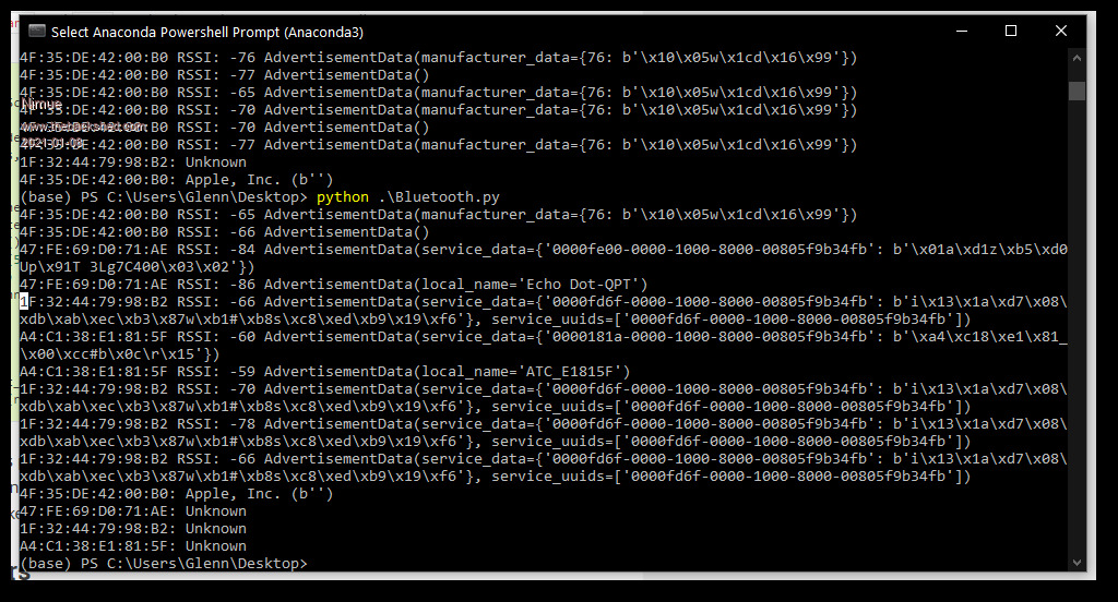

Having obtained these and flashed the custom rom (easy) I can confirm that the bluetooth low energy implementation seems to not be compatible with Python 3.9 running on Windows 10 (a Python issue).
Apparently it works fine on Linux (not my OS of choice).
I'll keep plugging away.
Nim
Nimue
Joined: 06/08/2020
Posts: 450
Posted: 11:06am 08 Jan 2021
Some progress....
The "Bleak" library :  https://bleak.readthedocs.io/en/latest/scanning.html works for reading the advertised bluetooth data...  with one caveat..... not under Anaconda / Jupyter notebooks.
So, under Windows 10 with the above libraries, I am able to "see" the sensior:
In the screenshot, the device is "ATC_E1815F" and the next couple of lines is the packet info for the data being sent.
Need to "park" this and do some paying work for a bit....
Nim
