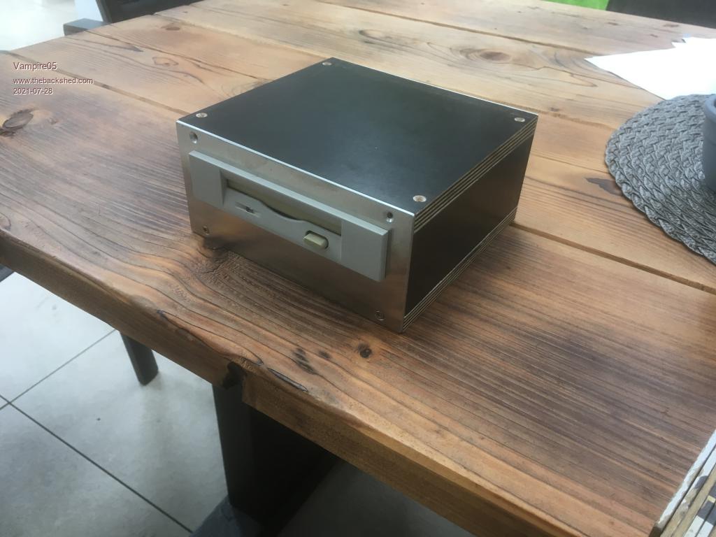

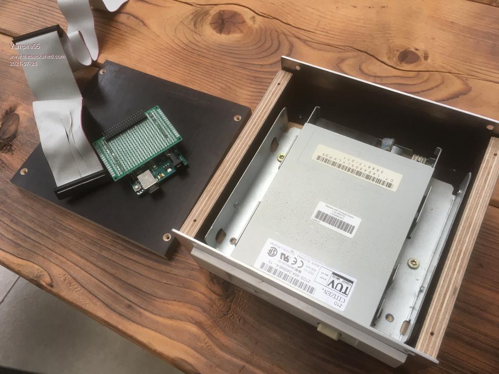

Today i finished the case for my external CMM2 Floppy Drive: Here some Pics:
The next Step is to mount an IDE (40 Pin) Connector on the backside for the CMM2 Connection.

Wow. That looks ROBUST!

these wooden panels and aluminuim sheets are the only material i have lying around here.

It won't blow off the table anyway. :)
Actually, I think it looks really neat. Your cutting and assembly look very precise.
