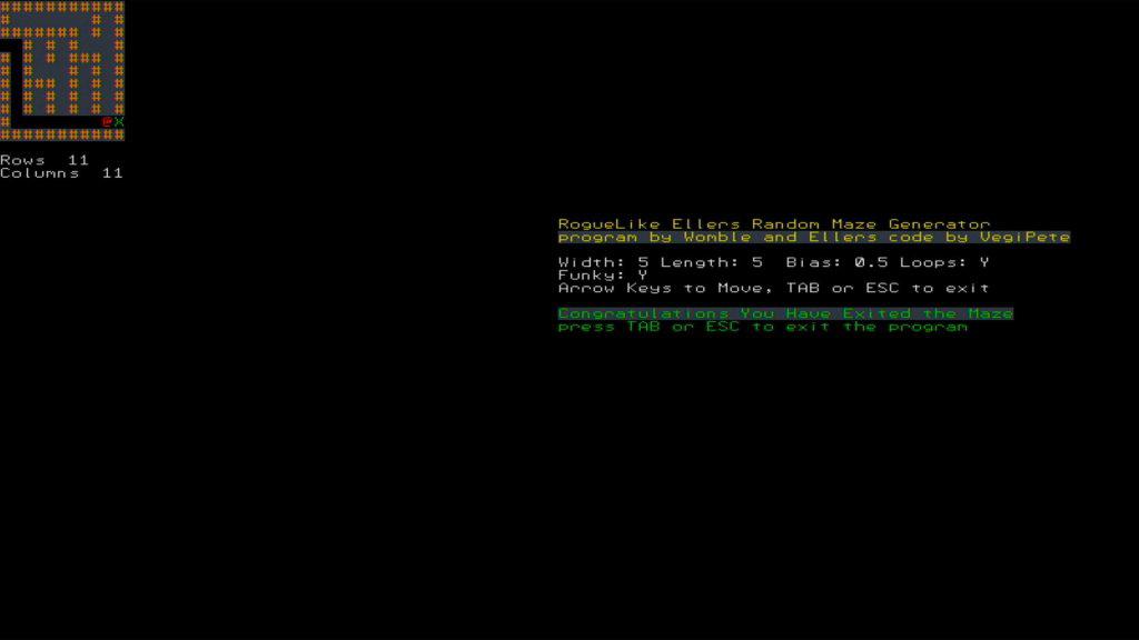

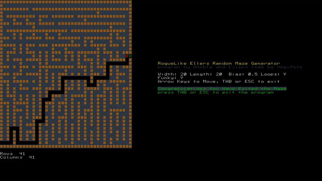

Your suggestion inspired me so I knocked this up today
' RogueLike using Random Maze Generator Subroutine
' v1.0 by Womble 27 October 2020
' https://www.thebackshed.com/forum/ViewTopic.php?FID=16&TID=12987#157644
' Implementation of Eller's Algorithm:
'   Written by Vegipete (vegipete@gmail.com)
'   June 2020
' Subroutined and Modified by Womble 27 October 2020
' https://www.thebackshed.com/forum/ViewTopic.php?FID=16&TID=12209
' Eller's algorithm generates pure simply connected mazes
' of arbitrary length.
' Horizontal/Vertical bias:
' .5 = even, lower = more horizontal,  higher = more vertical
' By introducing a deliberate 'bug', mazes with loops can
' be generated.
' RogueLike Elements of this program based on:
' Golfed Rogue
' https://codegolf.stackexchange.com/questions/7074/build-a-simple-roguelike
' also https://github.com/nrkn/SimpleRLGolf
' from a rec.games.roguelike.development post
' DLosc QBASIC solution posted on StackExchange on 21APL2015
' licenced under https://creativecommons.org/licenses/by-sa/3.0/
' modified and commented for CMM2 by Womble 26OCT2020
I realised that the credits were not clear enough, so tweaked it:
Here is the sourcecode: Ellers_MazeGenRogue.zip
Its a quick hack on my part, as a learning exercise.
Feel free to use or modify as you see fit.
My coding skills are very Rusty but I hope you like it
Many thanks to VegiPete for his Implementation of Eller's Algorithm.
