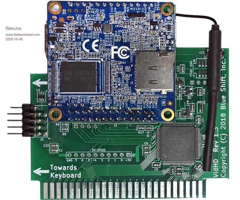

On that note, one interesting approach to circumventing the HDMI homebrew constraints is to use an entire SBC as an “HDMI server”.
For any Apple II owners, below is the “VidHD”, which uses an Orange PI SBC piggybacked on an Apple II expansion card, with firmware that scans the Apple’s display memory and outputs it through HDMI. A particularly impressive bit of engineering given the Apple II’s notoriously convoluted video system!
I bought one last year, and it works great, but some of the hoped-for upgraded firmware capabilities (in particular, using the Orange Pi’s on-board Wi-Fi) have not yet materialized - the antenna you see in the pic is as useless as the proverbial teats on a bull :)
It’s a dramatic contrast to Peter and Geoff’s torrid pace of innovation and FW releases !
