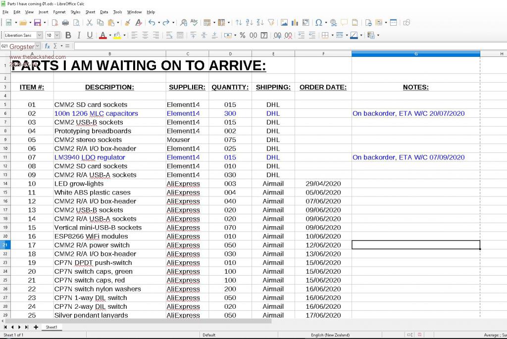

I have made a simple spreadsheet to keep track of all the bits I am waiting on to arrive, due to the massive delay in getting stuff cos of the virus. (with the exception of DHL or FedEx, naturally.)
Here is a screenshot:
This is fine, and it works, but I can only make the simplest of simple spreadsheets(cos I have not learnt how to do anything but simple stuff), so what I really want to be able to do, is delete rows as things arrive, and have column A auto-update the item number - otherwise if I receive item #17 for example, I then have to manually re-number all the numbers on the rows below.

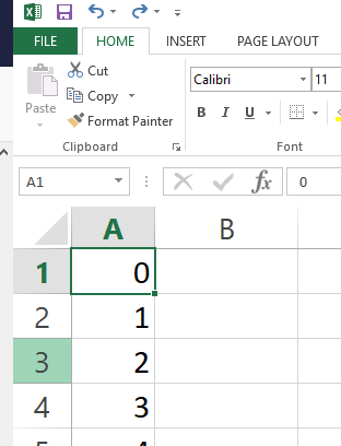

The VERY FAR left where the ROWS are numbered RIGHT CLICK on the number you want to delete and Excel brings up the menu and select DELETE The area to click is GREEN in this picture.

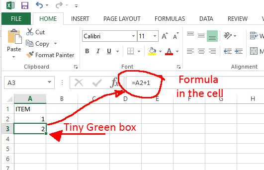

As to auto increment the Item#, just set the first cell as 1 then the one underneath (assuming cell is A2) is =A2+1 then the one under that as =A3+1 etc etc..
When a ROW is deleted the formula will auto update if you happen to delete the first row then just change the cell to 1 and the formulas keep going down
A simple way to copy the formula is to do the first formula in the second ROW (first row having the number 1 and see the tiny green box on the bottom right of Cell A3 in this picture click and hold whilst dragging down and the formula will auto complete till you let go

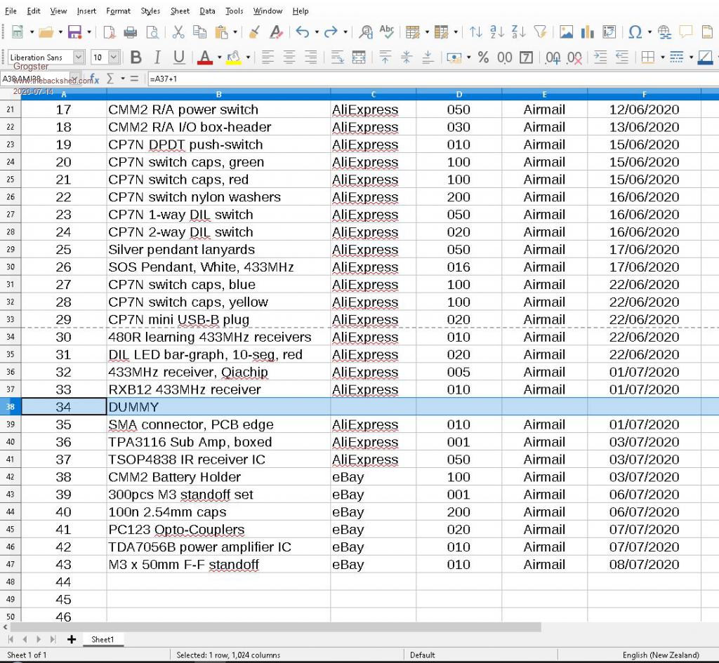

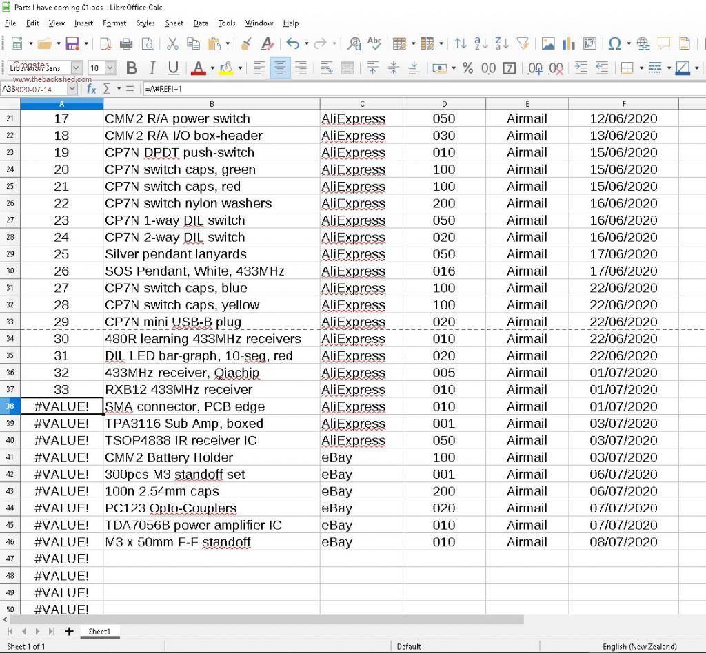

@ Mick: Does not want to co-operate.
....then if I delete row 38(item 34):
So, no luck there - the auto-update totally loses its reference to the first cell.
Thanks anyway.

Ok I just tested it you are right, I have used excel extensively and I can’t say I have ever seen this behaviour before..
I will think on it

The best I can come up with is when you get your #REF errors to redo the cells formula by clicking on the little green box bottom right of the last good cell formula and dragging down again to recreate the formulae for the cells that got affected..
At least it works and is quick and easy
Posted: 11:44am 14 Jul 2020
Grogster--if you click on the number 33 in the example above, Ctrl-C, click on the first "#VALUE!", Ctrl-V, all the numbers will come right. I face this all the time in my budget projection spreadsheet, and it's the solution I've come to accept.
