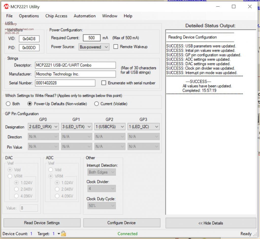

By default the MCP2221A only asks for 100mA from the host. However, it can be configured to request the maximum 500mA using a simple utility. This can be downloaded from the Microchip website but I attach it here for convenience
MCP2221Utility.zip
Just change the power required to 500mA and then click on the configure button. This is stored in FLASH so it is a one-off requirement. Microbridge equipped CMM2 ask for 500mA by default.

Posted: 10:02am 20 Jun 2020
Hey folks,
I'm sure the instructions in the first post are sufficient for the electronics savvy who mostly occupy The Back Shed, but I'm just a poor software guy who had only just started to flash LEDs when he was derailed by the arrival of the CMM2.
Courtesy of the White Wizzard I have a V3.0 motherboard with a WaveShare and a socketed M2221A.
* Is this one of the devices that needs updating?
* Why does it need updating?
* Do I update the M2221A in situ?
* Or is there some sort of "programmer" setup I need to use.
Posted: 10:08am 20 Jun 2020
  Quote   * Is this one of the devices that needs updating?
Yes
  Quote  * Why does it need updating?
because, if you are using a computer to supply power it is only requesting 100mA as part of the USB enumeration and the board takes 170-200mA. Most computers probably will supply the power anyway but they are not required to. Of course it is irrelevant if using the CMM2 stand-alone with a USB power supply
  Quote  Do I update the M2221A in situ?
Yes, just install and run the program I attached in the first post
  Quote  Or is there some sort of "programmer" setup I need to use.
No
