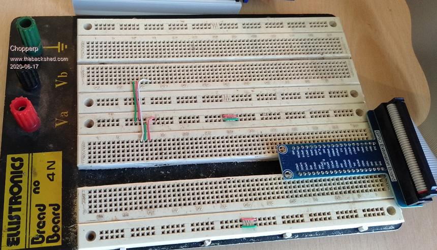

I dug up an old breadboard I "modified" a good while ago to fit the WW 44 pin uMite board .
(Carefully cut down the middle & prized bottom sections off. Just stuck back down with thin double sided tape).
I did have to modify the spacing to fit my CMM2 adapter board.
Yet to be tested.

Make sure that you get pin1 on the CMM2 going the the right end of the expander.
Red trace in your photo.

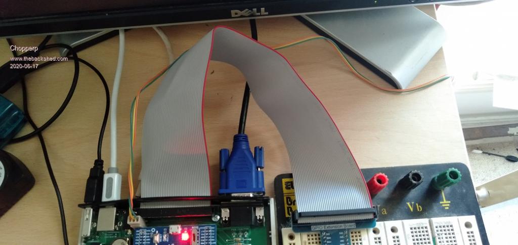

Thanks Jim.
Tripled checked that.
Made up a bespoke lead for it as well to fit more easily onto CG's board I/O pins.
The only real thing I've got connected is a temp sensor.
Brian

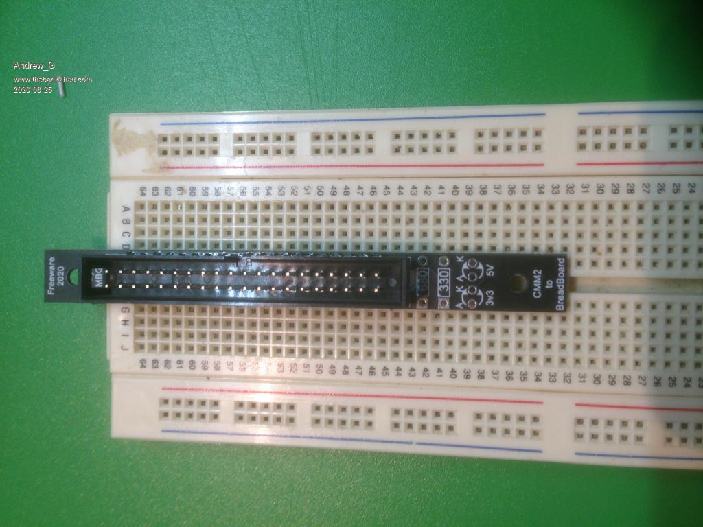

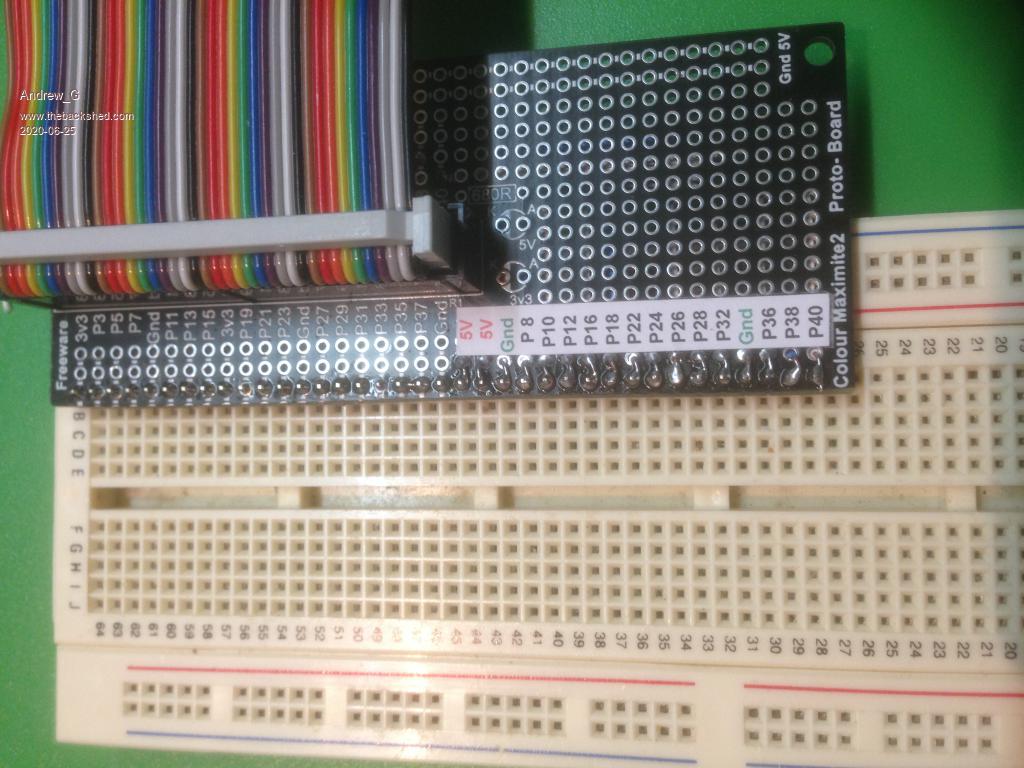

BigMik is too modest to say so but he has been working away on a couple of ideas that might have saved Brian's breadboard from being attacked. I assume he will "release" them in due course but here are some pics of what they look like:
and
I'm just a happy customer so contact BigMik for details.
Cheers,
Andrew

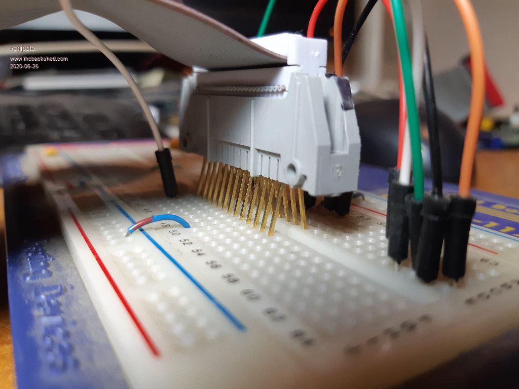

They may be mostly lost to the mists of time but wire wrap headers are such a simple solution for this purpose.
