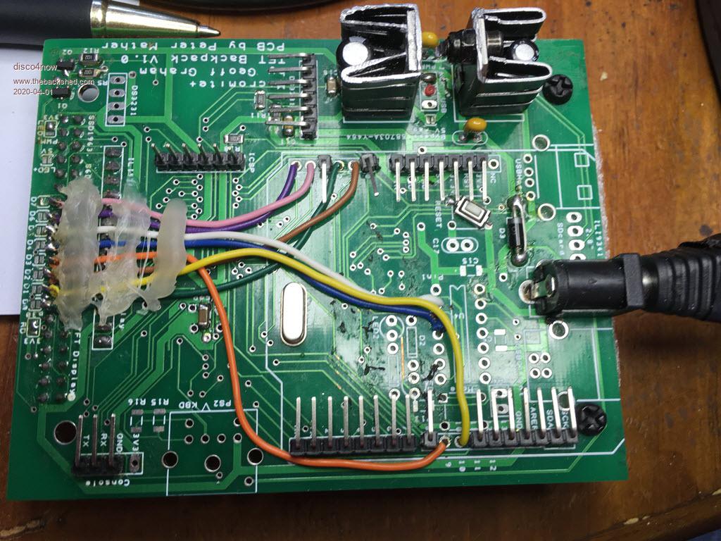

I have one I wrote some time ago. I ran extra wires on  peters M70 backpack as shown below.
This shows the pins I used for B8-B15
#ifdef MX470
Option->LCD_Reset=28;
p[0]=60;
p[1]=61;
p[2]=62;
p[3]=63;
p[4]=64;
p[5]=1;
p[6]=2;
p[7]=3;
p[8]=14;
p[9]=13;
p[10]=12;
p[11]=11;
p[12]=17;
p[13]=18;
p[14]=21;
p[15]=22;
I will post it up if this is what you are doing. I have this board setup to get any P16 LCD working first before I try to configure as 8 bit.
Most can be converted to 8 bit with a bit of hacking. See this thread.
8 bit conversion
Gerry
