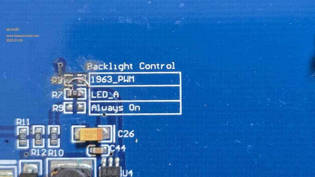

  Quote   I did cause visible over-heating. Can this have been enough to kill the lcdpanel?
It's hard to say, post a photo of the back of the panel showing the area of backlight links.
Also include a copy of OPTION LIST output.

Phil99, the photo above is attached.I have tried both ssd1963_7 and 7A at seperate times (disabled in between) and no luck. On a previous post, I had tries the "pixel" attempt which did not work, just as you say. I disabled option touch after that. When one changeds option, it asked to restart. After making sure to dusable any options and restaring the power supply,  'option list' shows no options. Then 'option lcdpanel ssd1963_7 , l, works as expected.

Your photo shows both 1963_PWM and LED_A bridged - R7 is a 0Ω link.
You need to remove one.
  Quote  Most SSD1963 based LCD panels have three pairs of solder pads on the PCB which are grouped under the
heading "Backlight Control". Normally the pair marked "LED-A" are shorted together with a zero ohm resistor
and this allows control of the backlight's brightness with a PWM (pulse width modulated) signal on the LED-A
pin of the display panel's main connector. The Micromite Plus fully supports this form of control and if you do
not want to be bothered with the details you can specify the I/O pin used to drive the LED-A pin in the OPTION
LCDPANEL command (below).
However, it is better to use the SSD1963 controller to generate this signal as it frees up one I/O pin and it allows
the brightness to be controlled with a finer degree of resolution (1% instead of 5% steps). To use the SSD1963 for
brightness control the zero ohm resistor should be removed from the pair marked "LED-A" and used to short the
nearby pair of solder pads marked "1963-PWM". The Micromite Plus can then control the brightness by sending
commands to the SSD1963 controller.
In either case the BACKLIGHT command will work the same and can be used to dynamically change the
display's brightness.
It might be easiest to snip off the link you added to 1963_PWM and enable the LED_A option in option lcdpanel and add a wire from pin 12 of the MM+ to LED_A.

From your photo it looks doubtful that the left end of the link you installed at R3 (or is it R8) actually connects to the PCB track coming from the via in the PCB just above the label for the link. Also you still have the shorting link at R7 in place, although this may not matter if you didn't connect anything to the LED_A pin on the SSD1963 connector.

If the area is too badly damaged perhaps move the 0Ω link to Always On as that should ensure the backlight works.
Another option to bypass the damage could be a thin wire from 1963_PWM into the via above R8.

I completely mossed the 0 ohms. I thought all 3 were open. I tries to solder the 1963_PWM link. I did read the manual and knew that only one link is needed, but missed the link on LED_A. As for Quote 2, that example is not for SSD1963_7 but for the 5". I used the pins as shown in the manual/addendum for the 7".

I need to record the extraordinaly help I have received from erbp to get my expore64 in good working order. The basic problem was the bad soldering on my part,
However erbp visited me and when it needed more work, he undertook to "overhaul" the many problems. He also uploade the Ver 5.05 firmware, and gave me very comprehensive documentation on hard copy as well as a usb-stick.He is very organised and thoroughly professional in everything he does. I have learnt a lot from him and I an encouraged to finish some more projects if spite of by poor eyesight.
