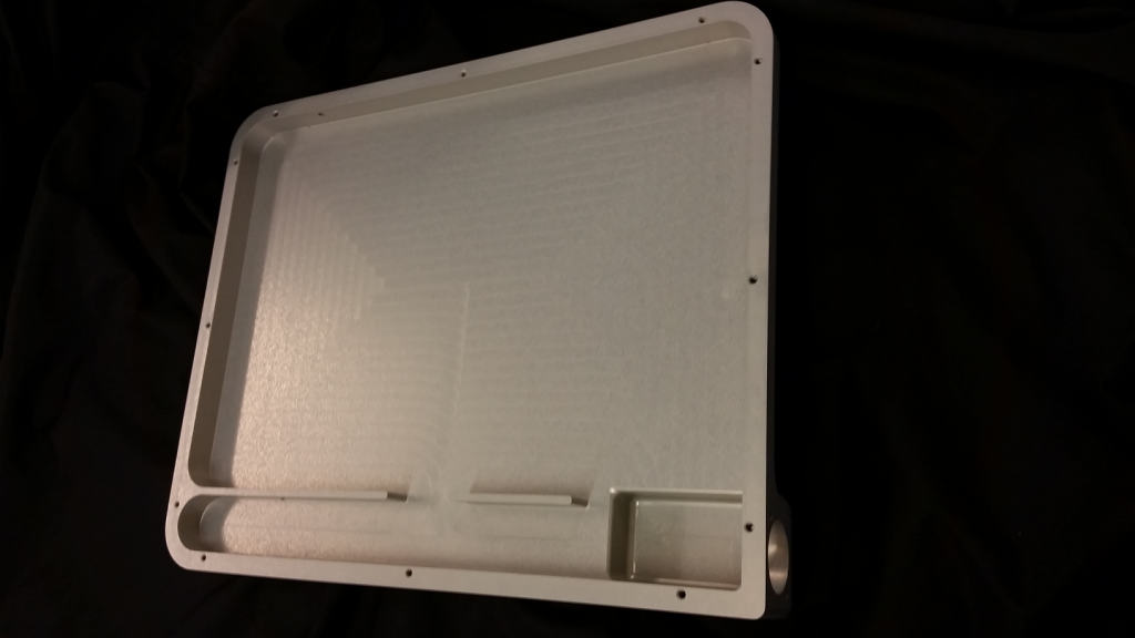

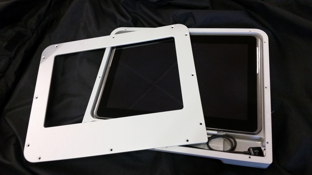

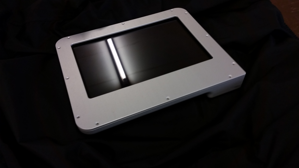

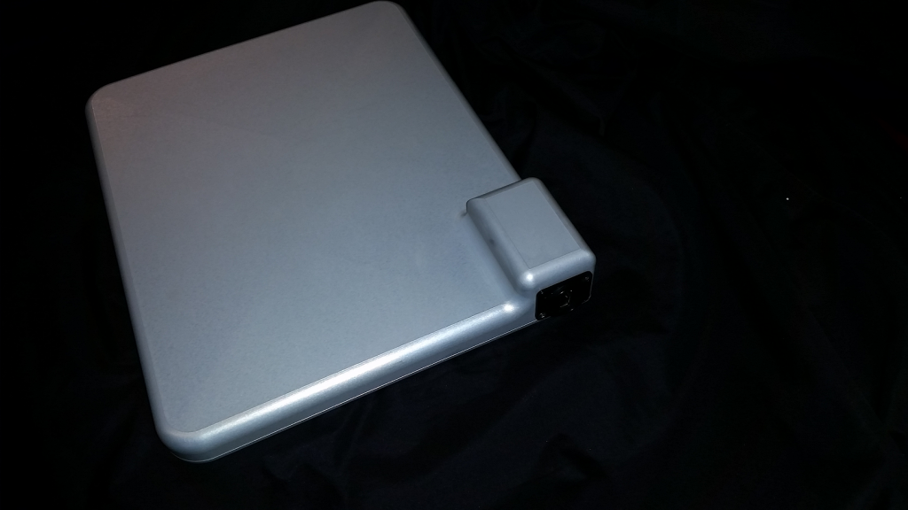

I had considered ToughPad (I have several ToughBooks) but just not tough enough for my liking:
A nice, beefy Neutrik locking USB connector....much more resilient.
I have another batch of these enclosures going through right now but these will be black anodized.
I don't touch Linux but I code for Android and it is just as easy as MM-Basic.

Posted: 12:23am 11 Nov 2019
Nice, they almost look explosion-proof. :)
Tinine
Joined: 30/03/2016
Posts: 1646
Posted: 01:13am 11 Nov 2019
With my coding? Yeah they need to be
