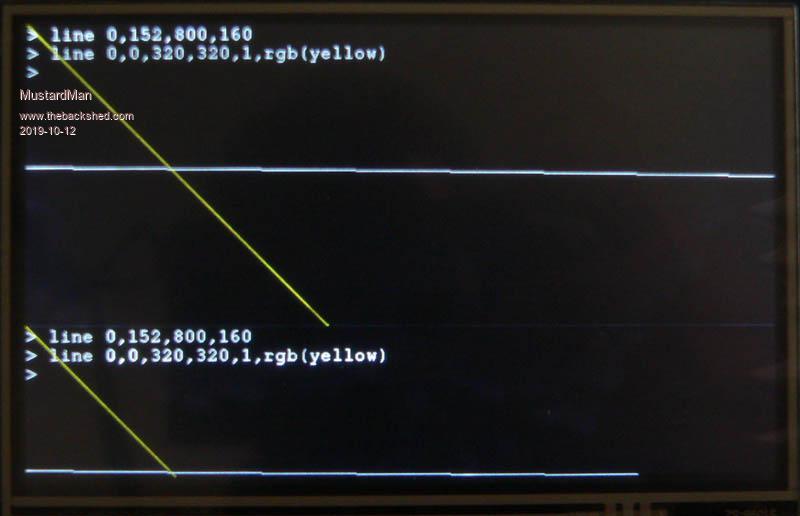

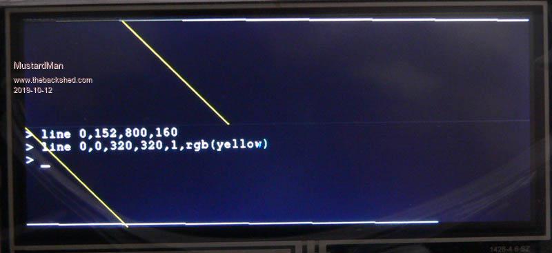

Frustrating... I've made tweaks to the MMbasic firmware (SSD1963.c and associated), but no matter what I do, the display does not operate correctly.
First test was to see if changing the firmware would work, and it appeared promising. When setting the Vertical size to 320 (my panel size), it displayed as expected on a 800x480 panel.
160 lines of the top section (800x320) are repeated from 320 to 480.
However, when I attach the genuine article, the 800x320 display, it displays the bottom section of what would notionally be a 800x480 screen, but all the rendering for a 320 height screen is performed correctly!
I've tweaked the pixel clock, the horizontal (and vertical of course) sync, the sync polarity, front & back porches (with absolutely no change to the display), and in desperation have started looking at other 1934 commands to tweak.
Any insight as to what is going on?

BuyDisplay got back to me... after I sent them a reminder. The very same day I sent them the reminder in fact! The first response got lost, to which they apologised for.
They explained, and with a bit of interpretation on my part, that the 'superwide' (800x320) TFT glass is exactly the same as the standard (800x480) TFT glass, it uses the same ILI6122 chip-on-glass controller, and with exactly the same parameters. The glass is simply "missing" the top 160 rows of pixels.
Hence, the "dirty hack" that I talked about was/is actually the correct way to access this display!
Pity it is the top 160 pixels missing and not the bottom. That would have made driving it a whole lot easier (not having to add 160 to every Y co-ordinate).
Also, in case anyone is interested, this display is refreshed from top-to-bottom, but not interlaced like a CRT TV is. Apart from that, it uses almost the same H/V timing.... V~60Hz, H~2x15kHz.
Cheers.
