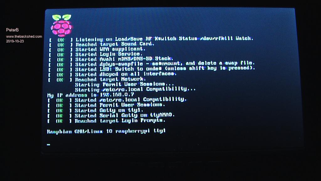

If this works it is a photo of my RPI ZERO driving a $50 7in truck rear view display.
The text is more readable than the photo indicates but is not perfect. It's like my writing, if you know what it says you can read it.
How do you photograph these things?
I still can't get mmbasic to work but the display does work and that is what I set out to prove/disprove.

Back again.
mmbasic is working and text does look better than pi text.
I can do basic graphics using OPTION LCDPANEL HDMI and my POLYGON looks good.
Advanced graphics gives DISPLAY NOT CONFIGURED. Has this been solved please.
Peter
edit. I should make it clear I am using video / TV / AV

The starting point for all this was, can a 7 in truck rear view display be used with a PIC? The answer is, Only if somebody designs a mmbasic to TV converter. I like to think I could have done it once, but not now.
However, the pi zero costs $10, can run mmbasic and has a TV output so my question has been answered in a round-about way.
