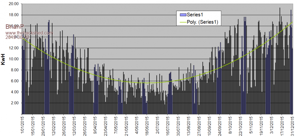

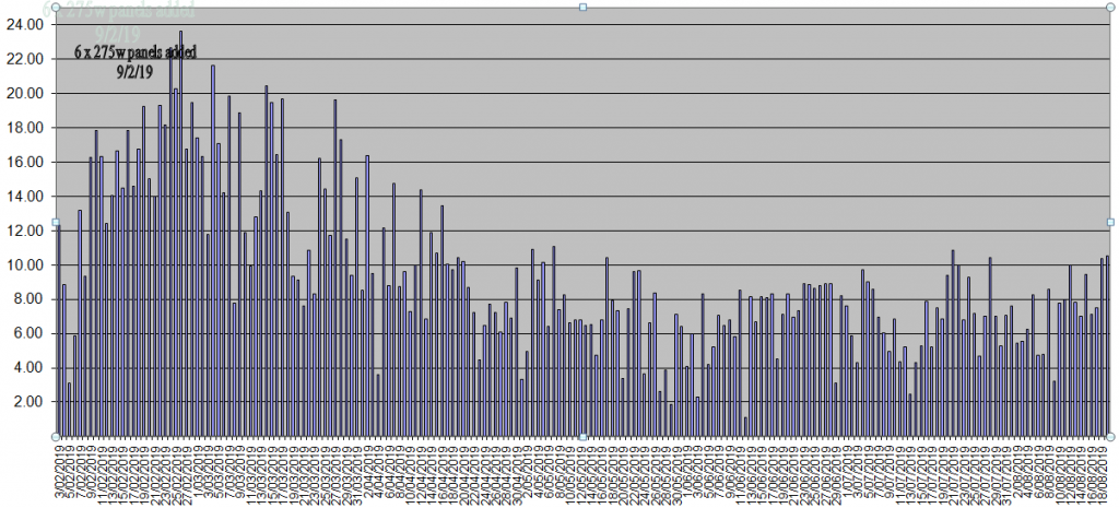

When all the panels are lit we have about 5Kw capacity, daily totals vary from 24Kwh to only 1 to 2 Kwh on a really bad winter's day.
Unfortunately ground mounting is not an option (no shading benefit) so we are stuck with the status quo.
Here's a couple of profile images to illustrate the variation.
The max. daily generation is also limited by the house consumption at the time & the battery capacity. If they are full, they are full! Currently on a full summer day charge we have just enough battery capacity to last overnight on the areas of the house that are connected to the inverter.
So, I need more panels & more batteries
Incidentally, the advantage of batteries is you still have power when there is a mains outage. With a battery-less grid feed installation no mains, no power!
B
