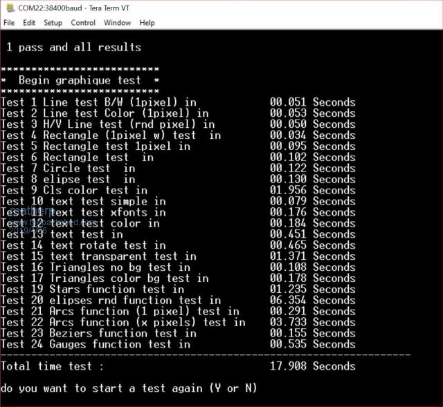

and here are the results on the direct attach ILI9341 (16-bit parallel)
Watch the video
