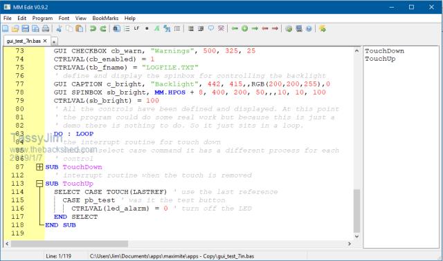

There is one that would be nice in MMEdit from a post by KeepIS. Function folding as an option, where only the first line of a function is shown with a + or - as the first character on the line to expand or contract the function (or sub).
E.G.
+ Function Max(a,b)
Posted: 07:33am 07 Jan 2019
  Turbo46 said   There is one that would be nice in MMEdit from a post by KeepIS. Function folding as an option, where only the first line of a function is shown with a + or - as the first character on the line to expand or contract the function (or sub).
E.G.
+ Function Max(a,b)
Folding is unlikely until I port MMEdit to a more powerful language.
I have pushed things as far as I can go.
I can do it with a better compiler:
No timeframe
Edited by TassyJim 2019-01-08

For the MMEdit wishlist:
It would be nice if the state of the 'Show Column marker' option (in the 'View' menu) could be saved between sessions. I use this option all the time, but each time I start MMEdit the option is reset and I have to go set it again. No biggie I know, but having it remember the previous setting would be great.
Thanks,
Phil.

Posted: 05:53am 08 Jan 2019
  erbp said   For the MMEdit wishlist:
Something I should have done from the beginning.
I will put on the to-do list.
Done:
It was remembering the column number but not whether to show or hide.
2019-01-08_164514_MMedit.zip
Jim Edited by TassyJim 2019-01-09
