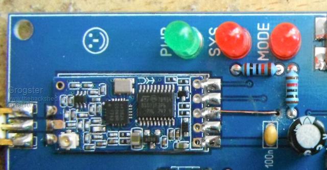

Latest board I am playing with, I could not work out why the HC12 module refused to talk back to the MM chip on COM1. No amount of tinkering fixed it. I even removed the HC12 thinking perhaps I had a dud - not that I have ever had any factory duds on those yet either.

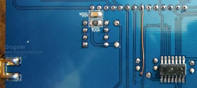

I thought I probably should do a quick continuity test with my multi-meter(set on junction test, which only allows about 0.5mA of current to flow). OK, circuit through SET line to MM chip. Circuit through TXD to MM chip. ......NO circuit from RXD to MM chip. Well, well, well. Checked a few times, and pulled out the MM chip to be sure. No circuit. Checked one of the other boards, and there WAS a circuit on those ones. I would have to pick up the dud one to assemble. Go figure.
Can't say I have ever seen this before(thank God!), and surprised that it got past the flying probe test in the factory. I fixed it by drilling out the via, and using some thin enamelled copper wire as a link from the HC12 on the top of the PCB, to the appropriate pad on the MM chip on the bottom.
Still, a good curvy ball thing, that one!
Everything is working as expected now, and the HC12 responds correctly.

Indeed. What with the reliability of modern PCB manufacture processes, I had to convince myself it was indeed an o/c via, so I tested it about five times to be totally sure!
Not something I have ever seen before. Vias are usually 100% reliable. My fix:
