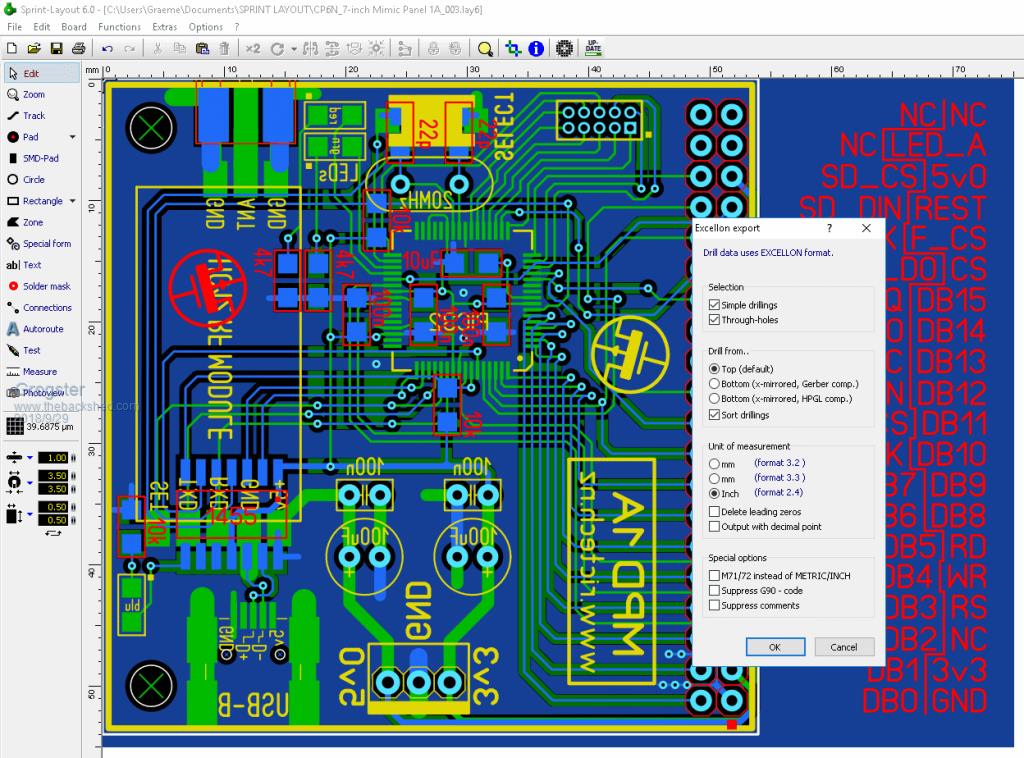

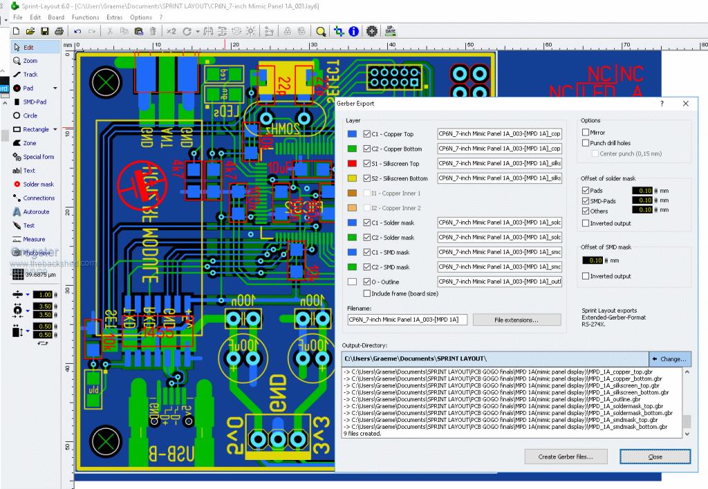

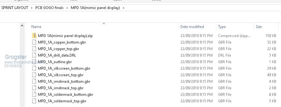

Like any other PCB design software, you need to send GOGO a full set of Gerber files - one file for each layer of the board. For a double-sided board, this usually results in eight files: Top Copper, Top Silkscreen, Top Soldermask, Bottom Copper, Bottom Silkscreen, Bottom Soldermask, Board Outline and the last file is the drill data for all the holes.
In Sprint Layout 6, you do this via FILE/EXPORT/GERBER EXPORT.
I select 0.1mm for the soldermask and SMD offset. In my case, I export two additional files, which are the SMD masks for the top and bottom SMD parts just in case the factory need them.
To export the drill data, go to FILE/EXPORT/DRILL DATA, and click OK. Most PCB houses use 2,4 Inch format.
That done, look in the folder you saved your files, and use something like 7zip(google for it if you need it) to zip all the files into a single ZIP file. This single file containing all the gerber files is what you upload to GOGO or other PCB house.
