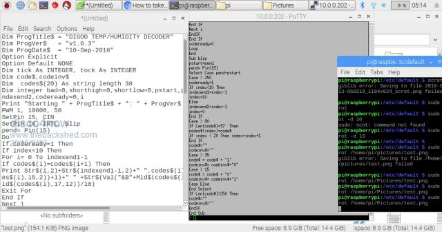

Posted: 01:18pm 12 Sep 2018
I remoted to my pi and can see what you are saying.
It seems that putty copies to its own buffer, not the clipboard. But google to the rescue.
1. Left Mouse Button and highlight the text to be copied in Putty
2. Place cursor in the text editor and press the Middle Button ie The mouse scroll wheel.
Works for me. I have trouble with the function keys. What are you setting to make these work.
Answer is here
regards
Gerry
PS. some mentions of both buttons together if no middle button. Not sure what you have.Edited by disco4now 2018-09-13

I have connected up a screen, keyboard and mouse with a scroll wheel.
So its working for me with:
Left Mouse and drag to select the code.
Click inside the text editor and press mouse scroll button to paste.
I downloaded and installed the mouseemu package and also was successful with F10 emulating the mouse middle button and triggering the paste.
I see the K400+ has an extra button top left as and extra left mouse.
Have you tried it when selecting.
sudo apt-get install mouseemu
Then edit the etc/default/mouseemu
file to enable F10 as mouse button
If you get it to work then I think you could pick another key if required.
# Defaults for mouseemu initscript (/etc/init.d/mouseemu)
# These are the default values on PowerPC. On all other architectures
# middle and right click are disabled by default.
# Key codes can be found in include/linux/input.h in the kernel headers
# or by using `showkey` in a console.
MID_CLICK="-middle 0 68" # F10 with no modifier
#MID_CLICK="-middle 125 272" # Left Apple Key (LEFTMETA) + click
#RIGHT_CLICK="-right 0 87" # F11 with no modifier
#RIGHT_CLICK="-right 29 272" # Left Ctrl + click
#SCROLL="-scroll 56" # Alt key
#TYPING_BLOCK="-typing-block 300" # block mouse for 300ms after a keypress
restart the mouseemu service after the edit.
sudo service mouseemu restart
