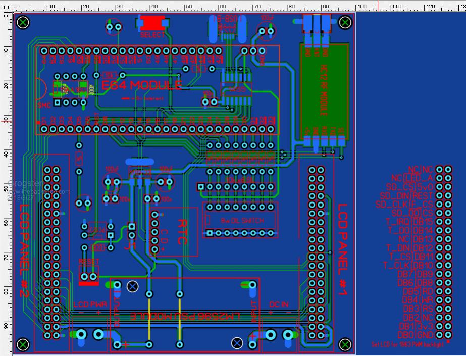

@ WW - 7" LCD panels. Running two of them in parallel. The LED back-light supply is a separate regulated 5v, but I wanted to make sure the 1963 chips did not suck too much current, as I plan to feed them from a 1703 regulator, and they can't handle more then 250mA max. I have designed a new board that connects only the data lines together - here was a thread about this recently, and other members have proved it works, so I am now doing the board for it.

Here's a sneak-peak at the PCB:
I need to redesign the 1455 side of things OUT of this layout, as the new 1D E64's fix that for me.

Looks nice.

Looks good G.
Out of interest, is it not worth considering using your New E64 instead? This is assuming there is enough space with the additional height of the daughter-board!
Nice sizing you squeezed it into there.

See my comment just below the image, Mr. WW

Too busy admiring your layout to see that comment!

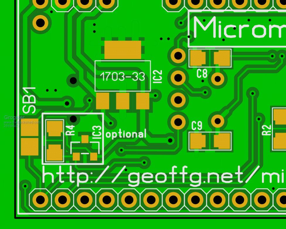

[Quote=WW]Personally I love the BP64+ , but this new PCB from G (if made available) will take its place (albeit slightly bigger).
Yes, once the 1A prototype passes my self-imposed quality control tests, then I will release all the Gerbers and drill data etc, as a constructor's pack.
EDIT: I am actually SERIOUSLY toying with the idea of including a 11AA160 memory chip that Geoff wrote drivers for, on the new board in SOT-23 footprint. Have not decided yet, but they are only 50c or something each.Edited by Grogster 2018-08-28

Worth adding the 11AA160 capability if space permits. If left unpopulated then the MM pin is still available (assuming it used an I/O). Win-Win

I was planning to make the UNIO pin a solder-blob. So then, if you wanted to enable the UNIO memory feature, you solder-blob the pads. If you DON'T want it, you can still use the pin as a standard pin.
EDIT: I like your idea of not populating it if you don't want it better then my solder-blob idea. Edited by Grogster 2018-08-28

Here you are, WW:
The 11AA160 is connected to Pin-30 on the E64. This pin does not have any other assigned task, it is just a plain I/O pin, so I figured this was a good one to go for.
I can't have the 11AA160 on any of the other pre-defined pins, as I am sure you would agree.

I was assuming you meant adding the 11AA160 to your 'Dual Screen' PCB - not the new E64. However, great idea to add onto the E64 as an 'Optional' install.
Two comments:
1> Is it worth adding some silk-screen wording to imply what it is for? Under 'Optional' put '11AA160' maybe!
2> Could you allow for TO-92 as well as SOT23. Not essential - just asking. I guess this depends on tracks on other side of PCB!
WW
Posts: 10114
Posted: 08:57am 27 Aug 2018
Yes, I am thinking of adding this to the 1B(production) 1D boards.
1) Good idea. Will do.
2) TO92 would be pretty much impossible due to stuff on the other side - Not gonna happen.
