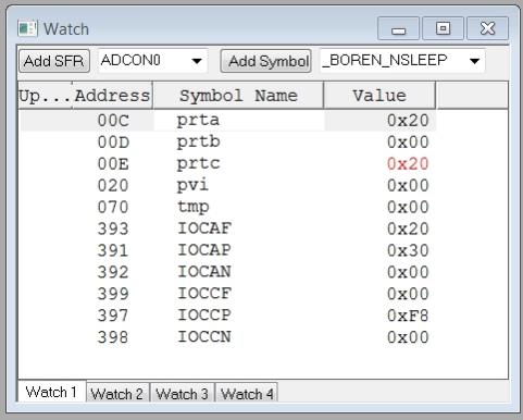

The IOCCF never changes at any stage as you can see in the attachment.
I have to change PORTA to exit from sleep.

Sorry I cannot read the text in the images they are too blurry.

I think I did understand your last point but you may a missed my point. The point I was trying to make is that the IOCCF is always 0 regardless of whether PORTC is changed in sleep or out of sleep. Whereas, the IOCAF changes as expected.
That's why I think it is a MPLAB software fault. I read somewhere that MPLAB 8.92 does not fully support this PIC.
See the attachments.

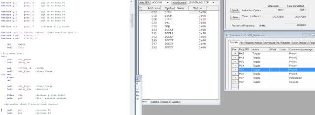

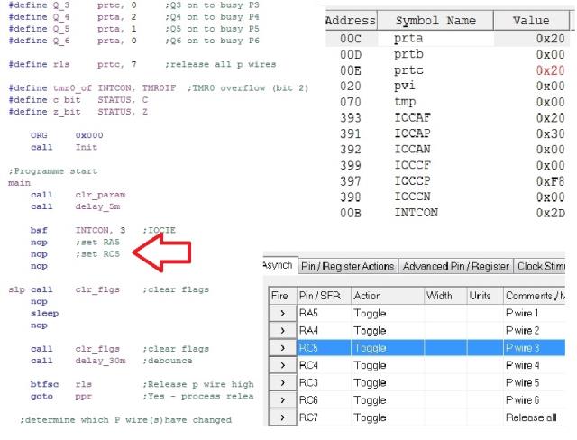

Posted: 05:25am 20 Aug 2018
Azure
I did as you suggested in your last point. I inserted some nop statements. I changed PORTA at the first nop & PORTC at the second. The attachment shows the result. IOCAF changed, but not IOCCF.
I made them larger, so I hope you can read it this time.

Are you doing this only as a software simulation or working with a real chip?
For the purpose of testing port C function you should not change any pin on Port A and just change a pin on port C to test it.
How are you clearing the flags?
