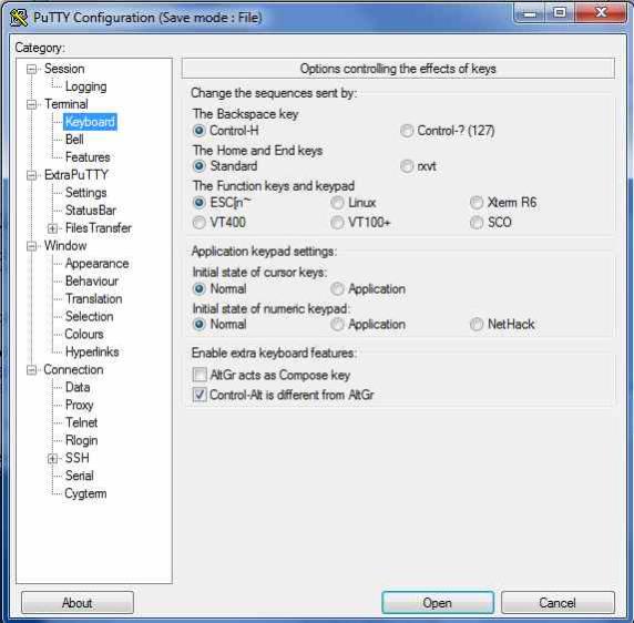

  CaptainBoing said   here you go, I exported by workbench session for you. If you pop the attached file in
C:\Program Files\ExtraPuTTY\Bin\Sessions (or whereever you store your putty sessions) you'll have all
the settings I use
2018-10-11_163839_lizby.zip
hth
Thank you for this, but I don't know where my putty sessions are stored. I have run putty from a folder other than "Program Files". There is no "ExtraPutty" folder in that directory or in "Program Files".
I downloaded the latest Putty version (.70), and it is in "Program Files". It found my sessions, but I still don't know of a folder where they are located (not in "Program Files\Putty"). The FAQ says they are in the registry, so I ran regedit and could see them there, but still no clue as to where to put the session file you sent. Any ideas?
Posted: 03:40pm 11 Oct 2018
ExtraPutty is just a version of Putty with some extras in it (like xModem etc)
go into putty, look through your sessions for one with a distinctive name then do a search on your C drive for it - that will find where putty is storing your sessions on your PC - or maybe your version is different from the version of Putty I use (I like config files and not hiding the data in the registry).
Failing that, here is the keyboard config from the session - I am hoping this will set your F keys correctly

You should left click in the putty console screen, then F10, then right-click the console screen - I think this is what you meant but just checking.
What speed is the MM running at? It will need time to process the input and if you are throwing stuff at it at 115K with CPU 10 or some such combination it might struggle. I have tended to standardize on CPU 48 and 9600 baud on everything (old tricks I guess plus HC-12's like it for maximum range so it's just a nice figure), but the default of 38400 transfers perfectly. I don't use any flow control.
Also, what usb<-->serial adapter are you using? I use CH340G throughout (got fed up with inconsistencies in drivers of the FTDI & Prolific) and I find them pretty bomb-proof... even better at 99p a pop. But, I also transfer flawlessly as above on one of WW's 44Pin Mk2s (my main breadboard/dev MM) so whichever chip that uses is good too.
I must say that during the AUTOSAVE transfer, the console screen doesn't always reflect the transferred data (leading spaces are particularly truncated) but the transfer is good and listing afterwards shows it is faithful to the editor copy. I have never had any problems transferring this way except from the USB terminal app on my phone - but that it not a major route for me so I am ok with not being able to upload that way. It would be a novelty if it worked but I can live without it.Edited by CaptainBoing 2018-10-15
