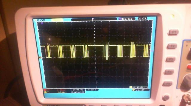

I used a DS3695 transceiver IC and a resistor ladder to get the 5v signal down to something safe for the MM input. By shear luck, I managed to get a scope shot of one of the ColdFire transmitted packets being sent to the MM receiver...
After several hours, I came up with this starting "test" program...

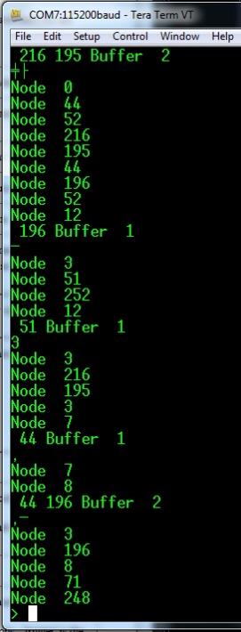

So, Originally, I was looking for a "1" on the 9th bit AND a match to the currently
set "node address" setup at the start of the program. Well after getting NO data ever received, I changed the bottom of the routine to open up the data gate on ANY received node address. I then actually started to get some action from the running program, but it's seems to be making not much sense..
It seems like the data is getting "out of sync" somehow because I know there should be no data packets being sent to the "wild" number of "nodes" being detected...

That data stream looks like it is not a simple transmission, there seems to be some sort of encoding within it (think Manchester, NRZ, biphase, etc). The timing of the positive and negative transitions varies at different times but there does not seem to be a clear start and end to each word transmitted assuming there are a few words there.
Not a problem but means you need to determine that encoding method. I would imagine that is why you can't make sense of the data (which is trying to read it as a simple serial stream).
Are you able to look inside the LCD display unit to see what it is using to decode the data stream (what is between the rs485 line and it's processor). sometimes older type equipment designs used specific serial protocol chips to do the bit stream decoding.
Failing that it would be good to check the timing on that signal train you captured to try and make progress from there. It would be good to measure the minimum pulse length on the smallest transitions and then use that to check if the next largest is 2x the smallest one.

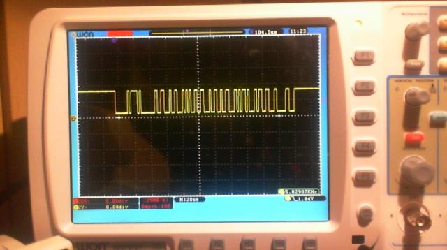

This Tx code is a single pass thing that transmits 2 "Packets", 1 for node 0, one for node 1. I took a look on the scope and it shows 2 groups of 4 bytes being sent..

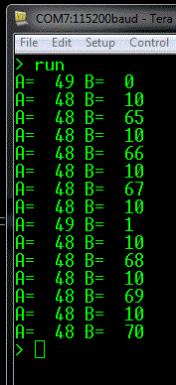

I got this back on the output of the E-100..
I got my data back and the correct node address target device codes, but I am not sure what the extra bytes that contain the "10" value are..
