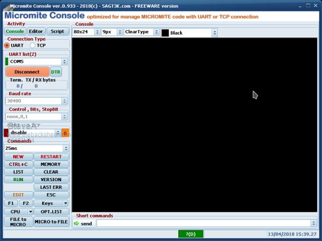

Posted: 02:49pm 13 Apr 2018
The baud rate is set to 38400, which works for the other programs.
I've attached a screenshot for you.

SteveA
Joined: 10/03/2017
Posts: 49
Posted: 05:51pm 13 Apr 2018
Yes, all the programs show two ports.
COM1 for the MM with serial to usb adaptor.
COM5 for the MM+.
I can click on connect and disconnect and your program responds, the boxes change between red and green, and a message at the bottom of the window confirms the connection etc.
But, if I type a 'short command' list or memory for example, and click on 'send' nothing happens. The TX/RX counts don't increase, and I don't even get any garbage in the console window.

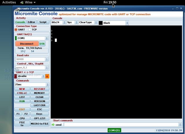

SteveA
Joined: 10/03/2017
Posts: 49
Posted: 02:51pm 16 Apr 2018
I now have MicromiteCons working, see the screenshot below:
It wouldn't run on Wine v1.6.2, but it will under v3.0.
To update wine in Ubuntu use:
sudo dpkg --add-architecture i386
sudo apt-add-repository 'https://dl.winehq.org/wine-builds/ubuntu/'
wget https://dl.winehq.org/wine-builds/Release.key && sudo apt-key add Release.key
sudo apt update && sudo apt install winehq-stable
