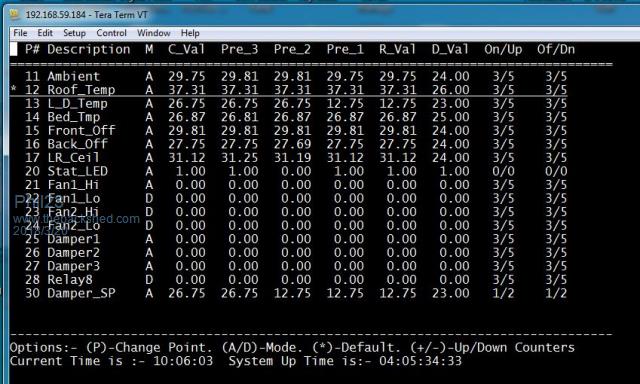

  pcaffalldavis said  BUT! It reads 85 C instead of 6 C. What is that about?
Exactly 85°C, I see precisely that reading occasionally on one of my "Still on Breadboard" projects.
The solution is usually to wiggle all the wires, the 4.7k resistor & the plug in 5/3.3V breadboard power supply I use.
Have never ascertained which is at fault; 5V rail, pull-up or data line, but it always comes good indicating something is wrong; bits dropped maybe...
85 is the error reading it does 90% of the time, but there are occasions when it's -16.5.
The real board is WIP... In my head...
Someone curious might translate this error in a binary way, for a better explanation of what's happening.
Phil.

If you want to get brave you can add multiple DS18B20's onto a single cable.
I've mentioned it in some other threads.
One of my projects has 5 & the other 7. All daisy chained together.
Makes life a whole lot easier not having to run 7 cables up into the roof & to each room.
Just have a flat telephone cable with droppers.
Total run length is about 30m.
Phil.
