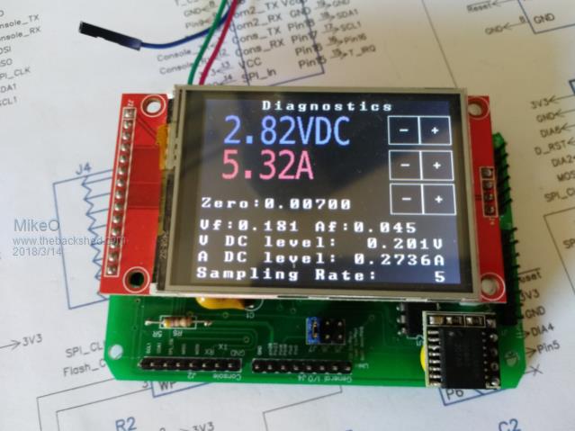

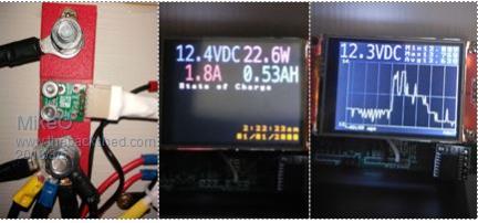

This status display is to be installed in my Caravan. The pictures are from the
first test run. The code is a much modified version of the SC AC Energy meter. The Graphing and Logging facilities have been retained, Amp Hour and State of Charge calculation are added. Current sense is via a ASC711EX current sensor.

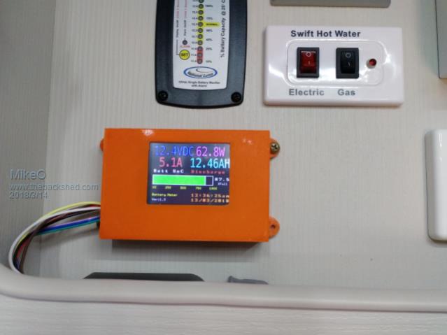

Installed !! and working really well, better than I had expected I have to say.
Just some trimming of the SoC calculations etc to do but otherwise all functioning.
Reads Battery voltage and current (Charge and Discharge)
Calculates watts and expended Load in Amp Hours
Calculates Battery State of Charge
Plots Voltage and Current
Diagnostics GUI with Voltage/Current and Offset adjustments
Current code etc on my server

Its all software really, its took me Age......s to work out how the SC software was functioning and to remodel to suit low voltage battery monitoring. It doesn't use the cfunctions they had for voltage and current sensing as I didn't need the speed they did plus no zero crossing etc. This has been replaced with my own routines for current sense and stabilisation, average sampling and averaging is ~50/sec. Also the cfunction for tariff calculations was not required. Ploting and logging is retained but turned off as a default, not sure of its day to day usefulness but it could be as a diagnostic tool. Even so its still uses most of the memory but its very responsive and seems quite accurate and stable. The MX170 chip still amazes me , how it performs and what can be achieved with it without going to the 470 and beyond with all their expense and extra complexity.
The 170 is still my go to chip simple, low component count and what's more
I can see the pins!
I will be posting the hardware requirement on my server soon but they are quite simple and can be done on vero and married with a 170 backpack. I have used my 8 port controller board (1.3) and I am considering a ver 1.4 with some further functions .
