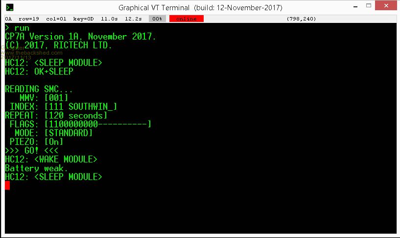

I've just uploaded the latest version of GFXterm to the document register:
http://www.thebackshed.com/docregister/ViewDoc.asp?DocID=22
This contains a number of improvements over earlier versions, including:
- detecting when a serial USB device has been unplug
- mouse scroll wheel support within the micromite editor
- more reliable pasting into the micromite editor
- X10 mouse position reporting (now the same as in teraterm)
- graphics are turned off until accessed, in theory improving performance
- expanded documentation
"GFXterm has been designed as a simple terminal emulator for use with Geoff Graham's single-chip Micromite computers running MMbasic. As such, it provides just enough VT100/ANSI emulation to use the Micromite's inbuilt editor with an 80 column by 24 line screen size.
In addition, GFXterm supports a simple set of graphics extensions that are suitable for drawing very basic rolling graphs.
Mouse scroll wheel activity is mapped to the cursor up/down keys, and will work with the Micromite's internal editor. X10 mouse position reporting is also supported.
Full source code (Delphi 5) is provided, however the only file required for use is GFXterm.exe."

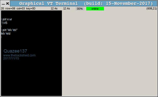

Just ran it under wine here is a screenshot
not sure the cause of the missing pixel columns.
will be nice to have 4 to 6 of these running and talking to my mites

Quazee137: regarding running under linux/wine, i am quite surprised it got as far as it did! under the hood, GFXterm employs some pretty odd stuff that is very wine-unfriendly. from your screenshot it looks like the overlaying graphics objects are not stacking one on top of another; this is likely a limitation of wine. however, since GFXterm is written in Delphi there is no reason why someone couldn't port it to a linux native application using Lazarus:
https://www.lazarus-ide.org/
