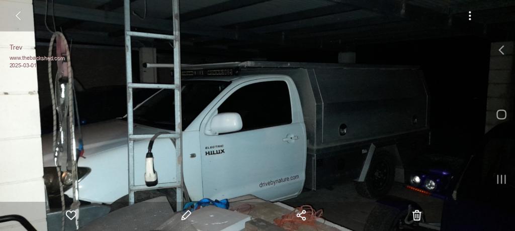

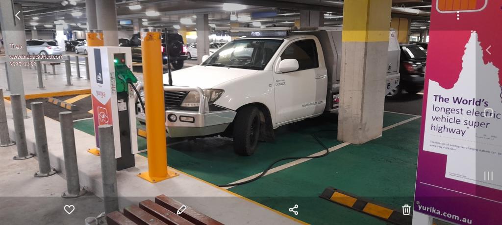

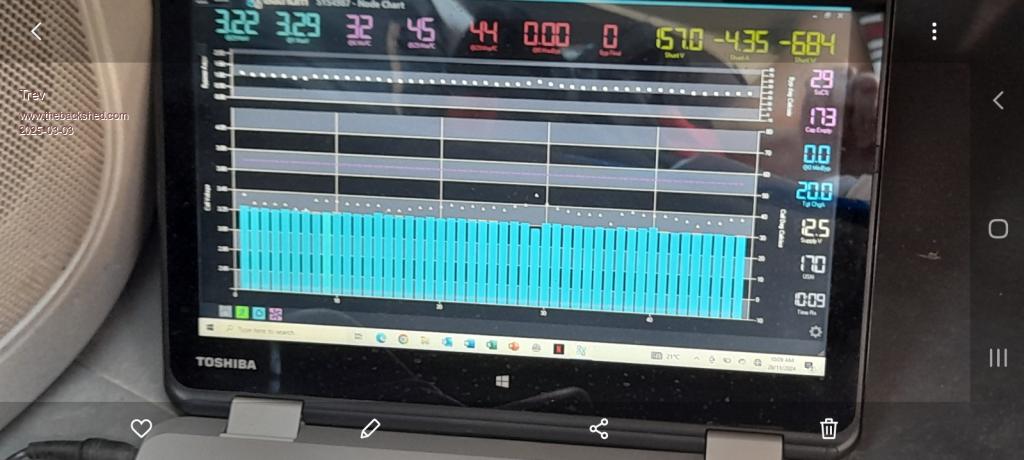

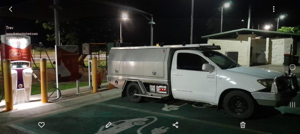

Another EV drive, but with a different vehicle. Last year, 2024 Dale (my son) and I converted  his 2005 Hilux to electric drive.
This is the first long distance drive for this Hilux
Left home at 5.20am
Drove to Carmilla 140km
Arrived 7.23am
Using 45% (used 271Ah)
Drove mostly at 80km/hr

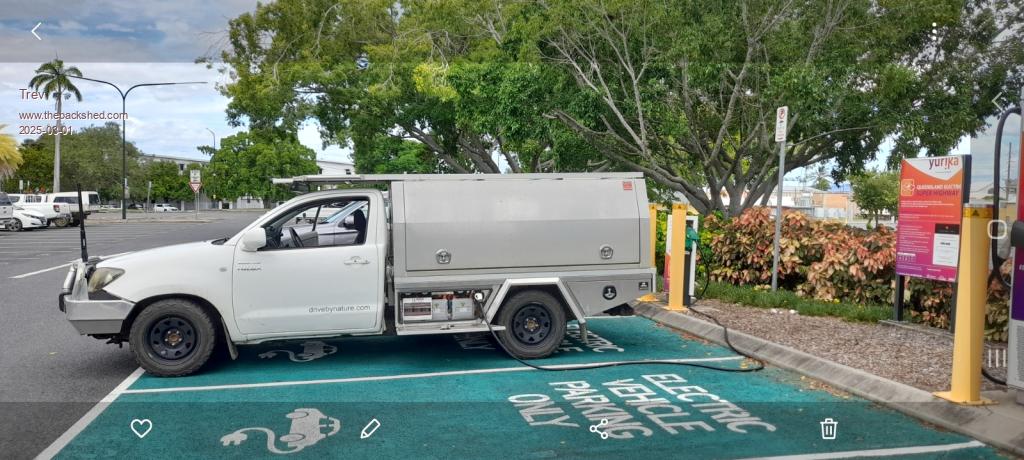

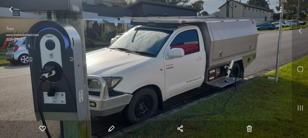

Charging at Carmilla
Charge rate 119A
Trev @ drivebynature.com

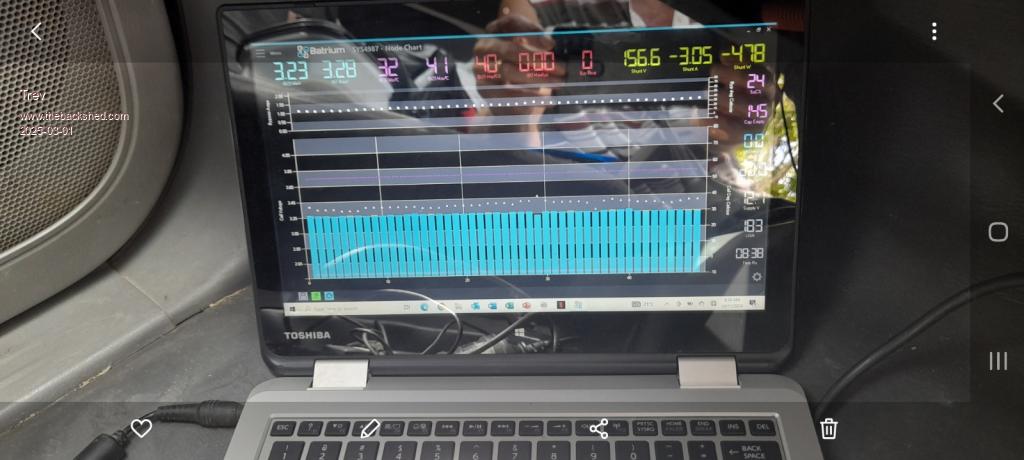

Early hours of the morning, hardly any traffic on the road.....testing/ calculating potential range. Close on 2500kg travelling weight.
80km/hr, 80% DOD 238km. 100% DOD 298km
60km/hr, 80% DOD 299km. 100% DOD 374Km

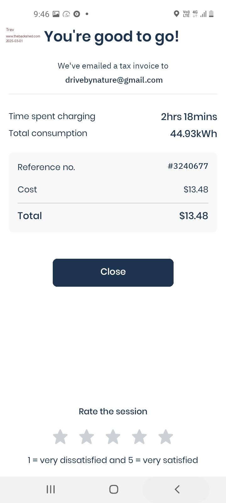

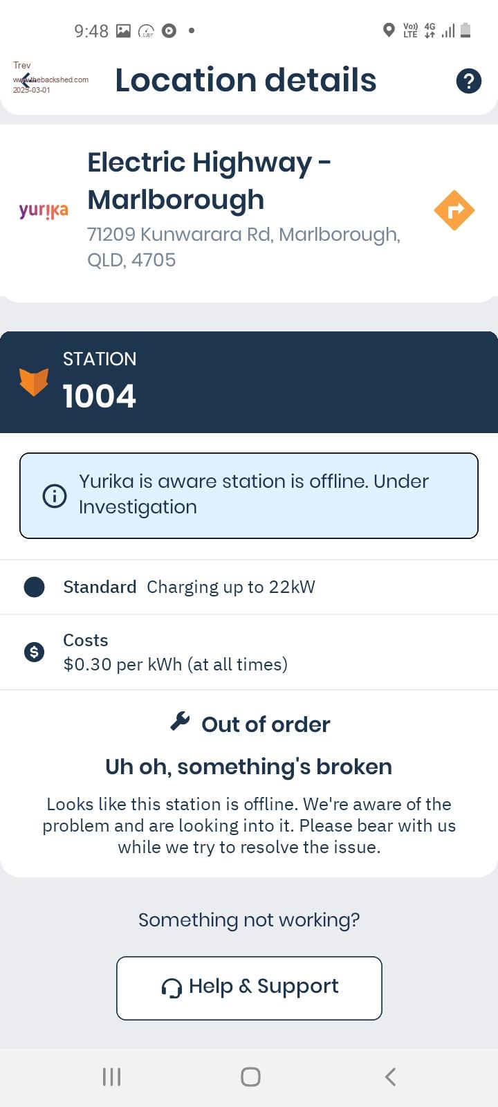

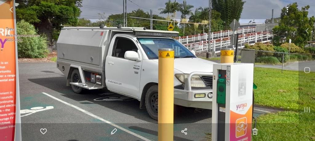

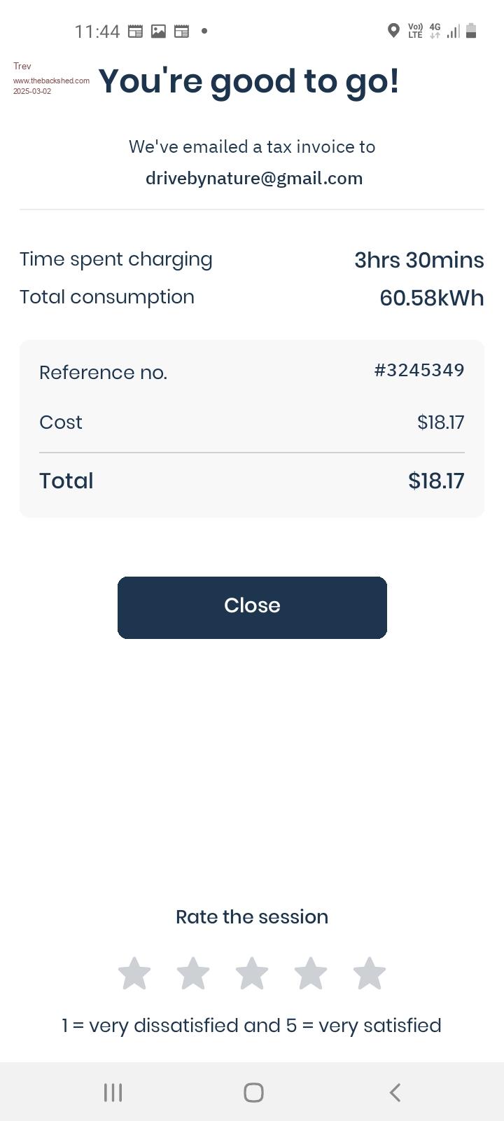

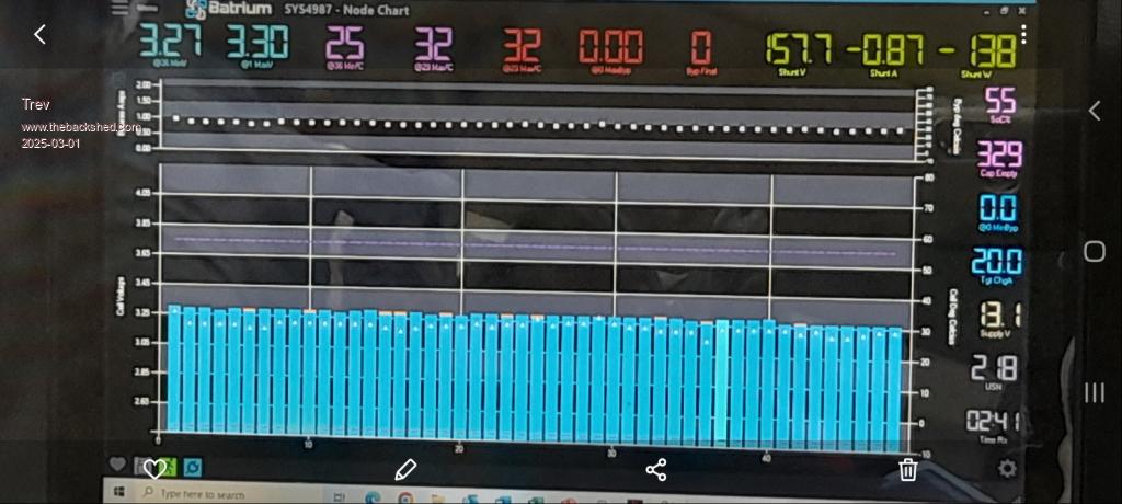

Here is the Chargefox data for Carmilla.
Left Carmilla at 9.50am. Skipped Marlborough because it was not working.
Thinking my range was a bit short at 80km/hr, I drove the first 30% DOD at 60km/hr. Only saw 10 or 20 vehicles and some of them were going the other way. Easiest enough to pull over and let those behind pass.

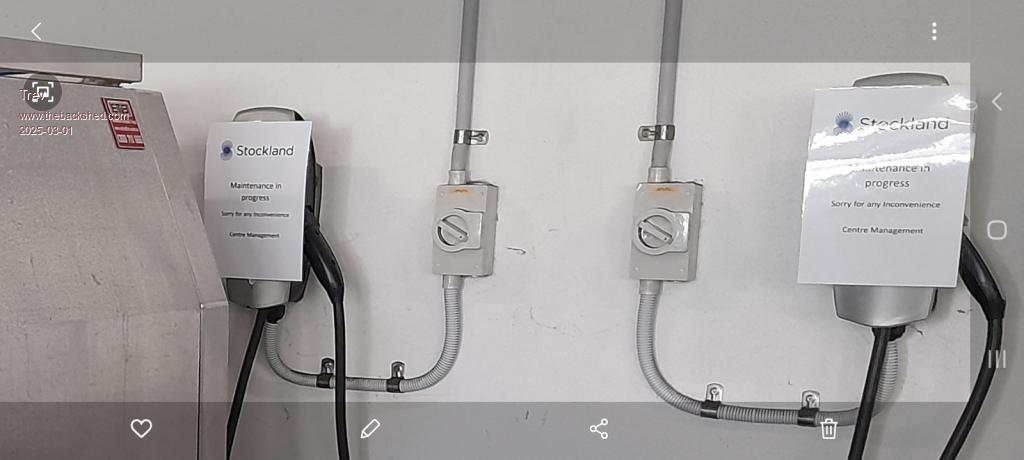

Arrived at Rockhampton shopping centre and found the charger outlets were out of action for maintenance.
Then went to the public charger outlets at the Council building. Drove 227km using 76% (455Ah). Arrived 1.22pm.

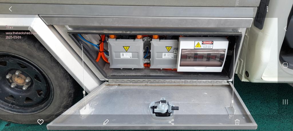

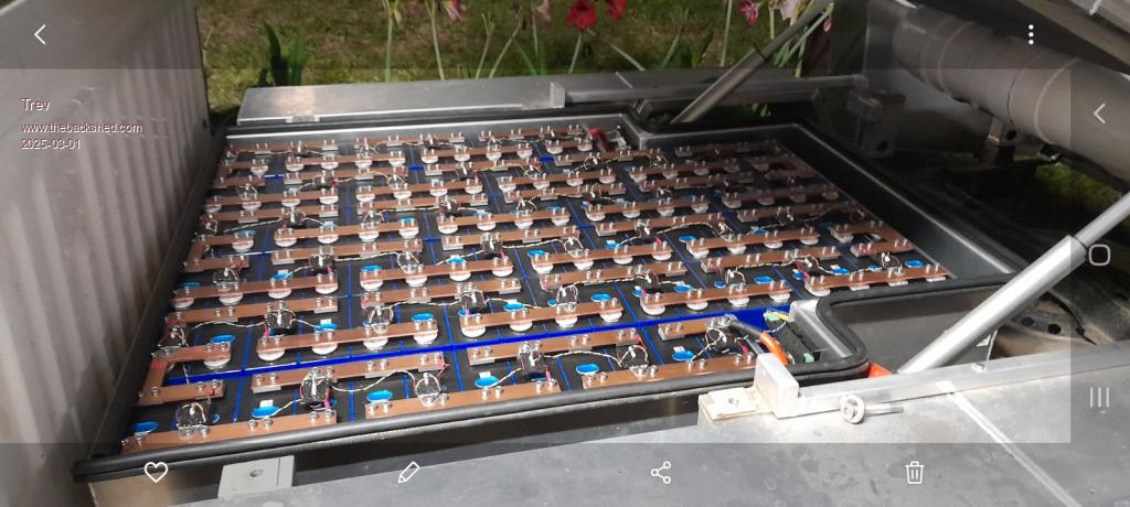

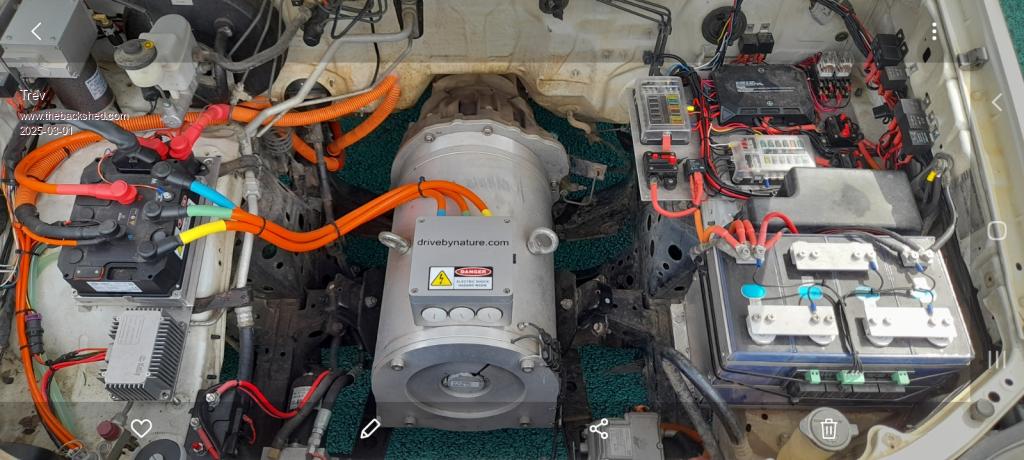

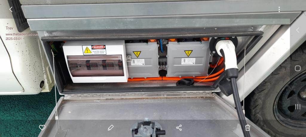

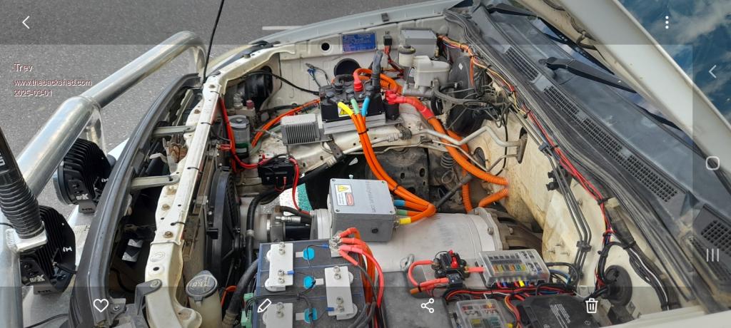

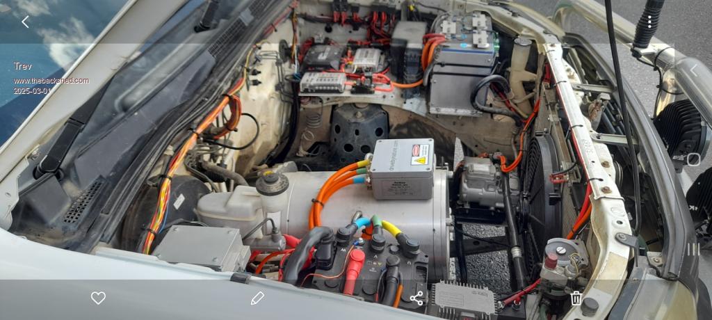

Pete, we are trialling EVE cells, 300Ah. Winston cells are excellent, but with EVE we could get 600Ah in the space.
This is the best picture I could find on my phone.
Under the bonnet
6 chargers. 3 on each side.
Edited 2025-03-01 14:51 by Trev

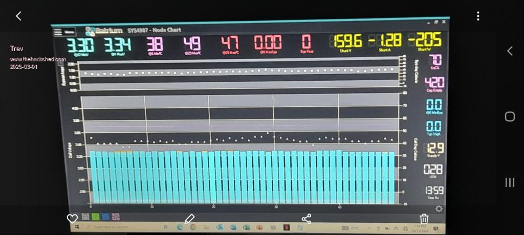

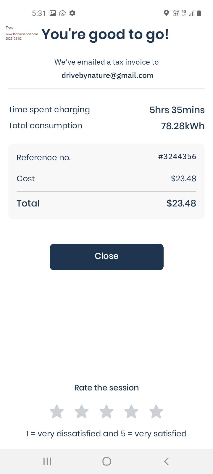

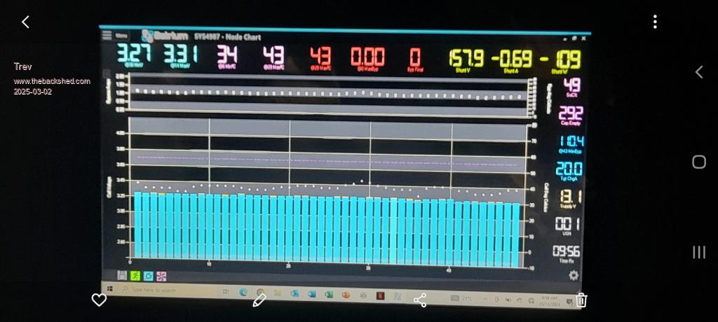

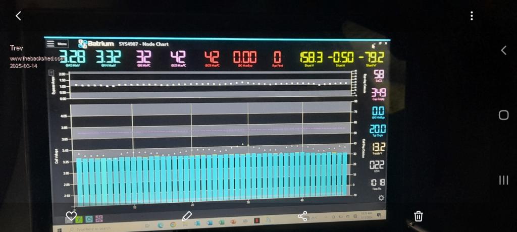

Charge for data for Rockhampton
Not quite full. I shut off the charge at 98%. Battery temperature kept shutting down the chargers. I have the BMS set to shut them down at 48C. So from 90% to 98% I could only run 3 chargers to keep the temperature down. A very hot day.
I left Rockhampton at 5.45pm.
Drove mostly 80km/hr. I wanted to drive at 100km/hr but the head wind has been strong all day. The outskirts off cyclone Alfred. Plus the battery temperature being up high.

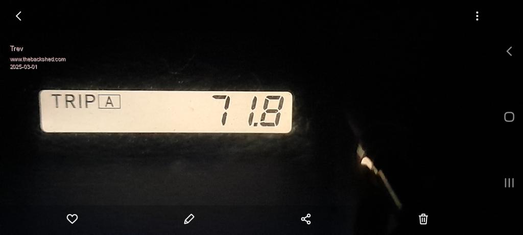

Arrived at Mt Larcom 6.43pm, just as it was getting dark. 30% DOD. Only 72km.

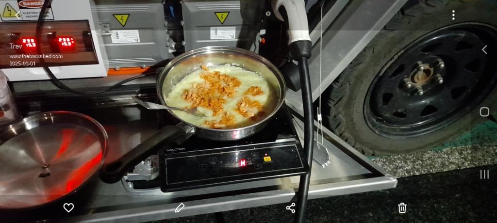

Simple dinner tonight. Mashed potato, onion, salmon and a little tomato.
Yes I have vehicle 2 load as they call it. With my EV Hilux (not this one yet) I also can do vehicle 2 house.

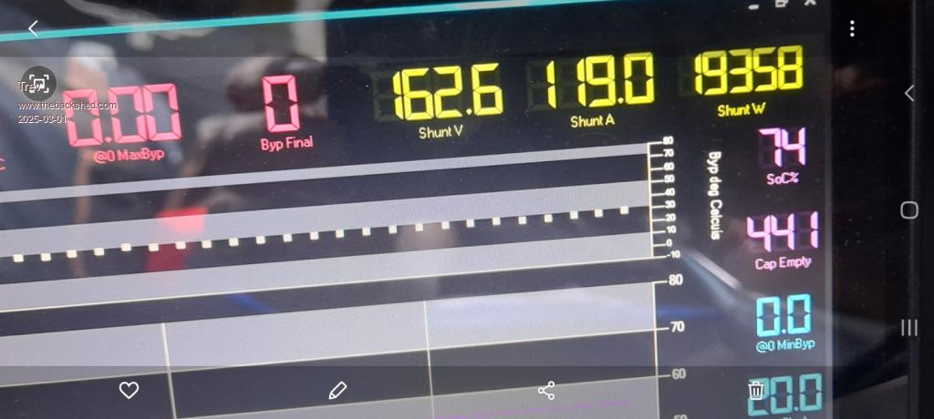

Charge for data for Mt Larcom.
Left Mt. Larcom at 8.30pm

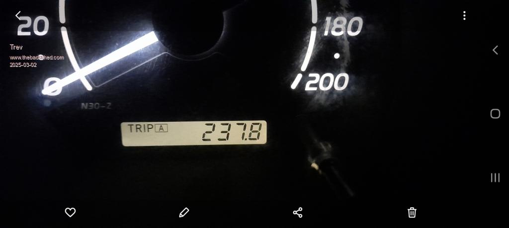

Drove 238km, mostly at 80km/hr. Some at 60km/hr, it is very hilly. Used 77%, 23% remaining. Used 462Ah, 138Ah remaining.

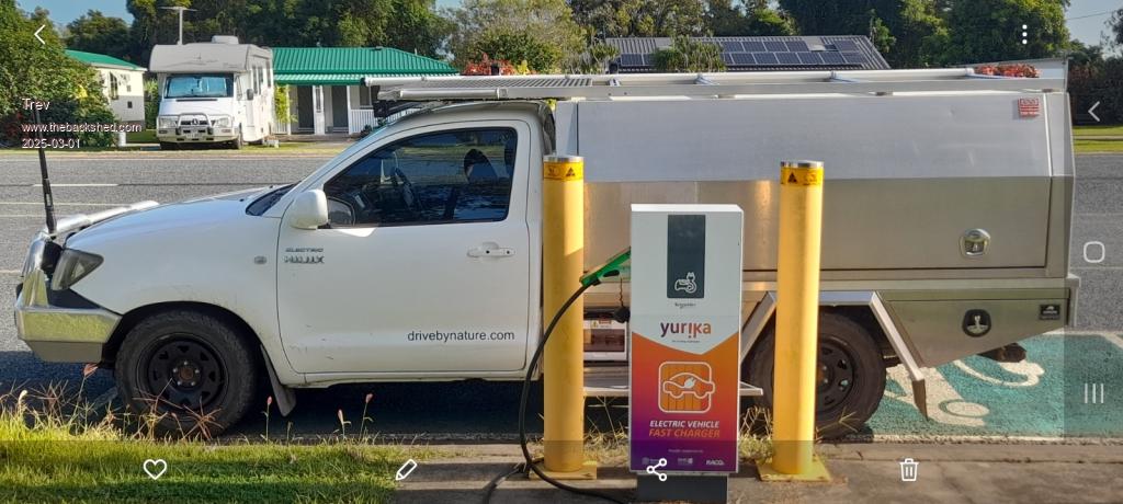

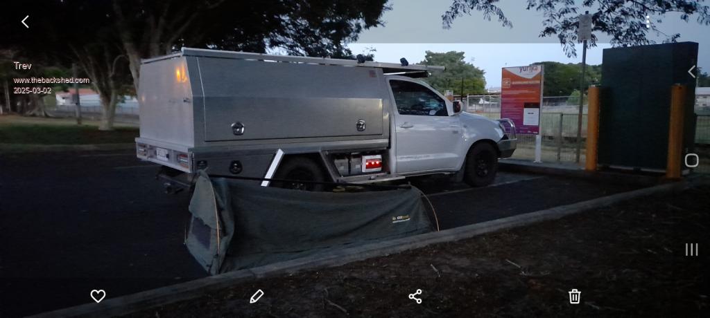

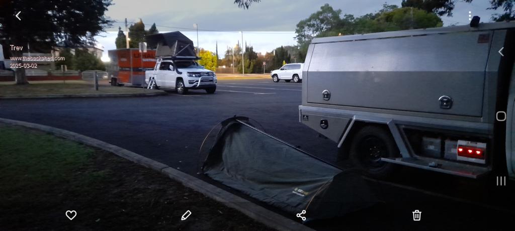

Arrived at Childers free  RV and Camping  at 11.53pm. Plugged in and set up swag for a sleep. Picture this morning, day 2.
Chargefox data for Childers

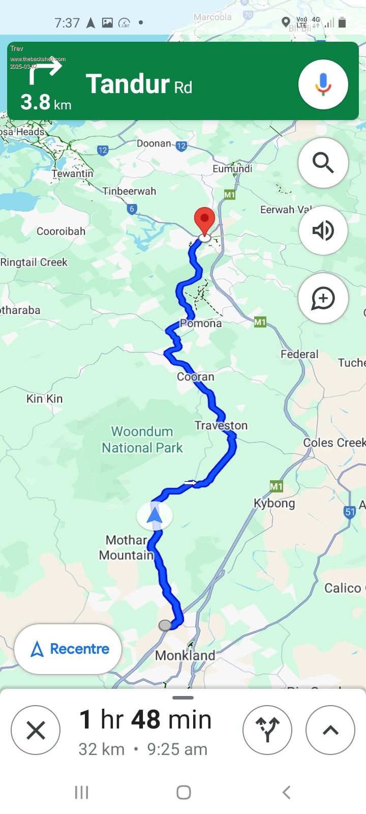

Drove to Cooroy. Skinny took me on a scenic tour, 32km through the mountains. Google maps, I call her skinny. She has to be skinny to fit in my phone. Up and down, round and round. Swapping roads, must have been like 10 different roads or something. See the freeway to the right of skinnies billy goat track.
Arrived at Cooroy at 8.11am
Drove 179km, no different to the freeway distance, but......much slower.
Used 62% or 375Ah.

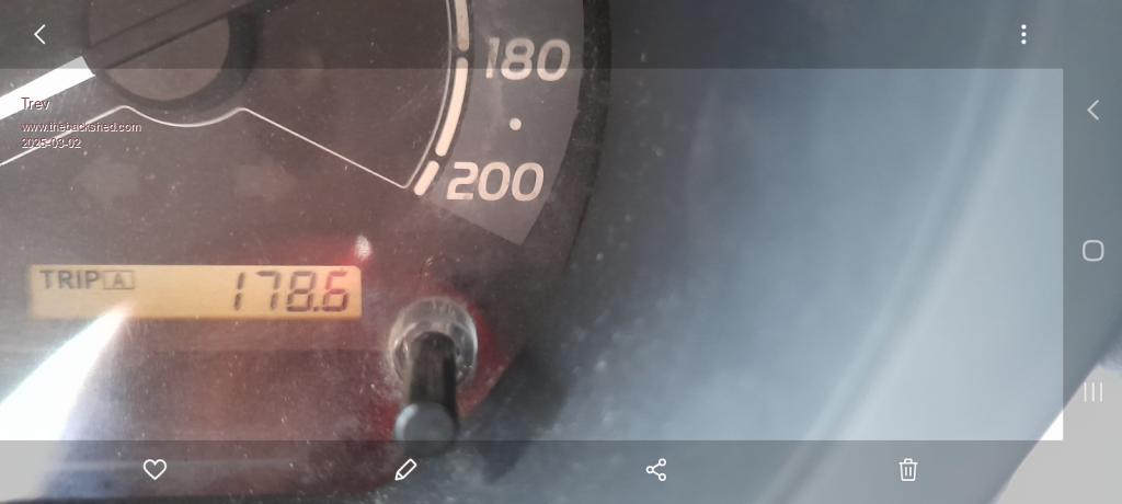

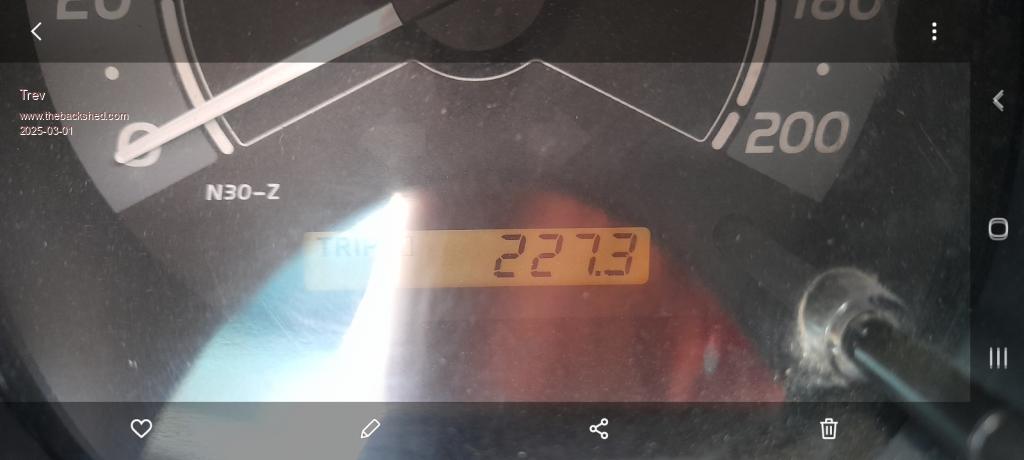

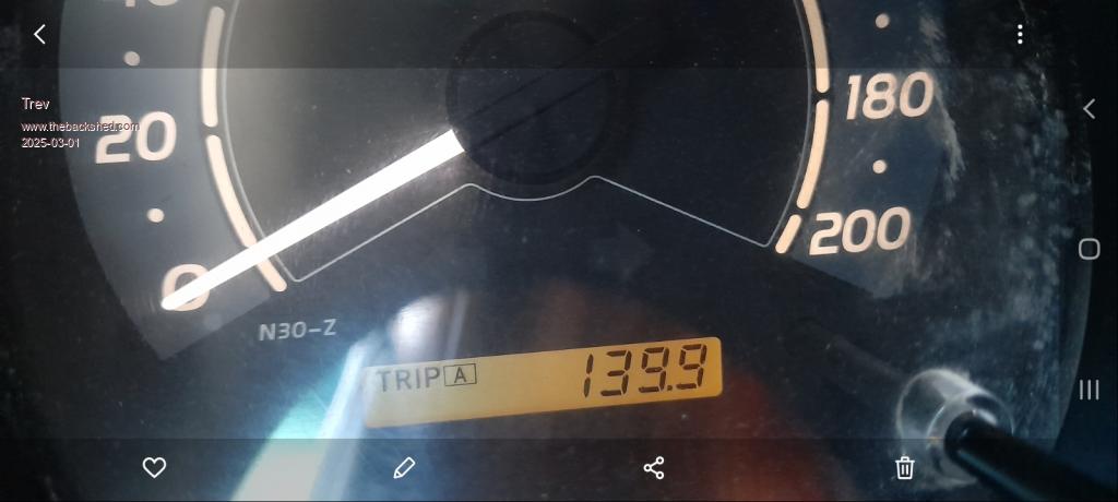

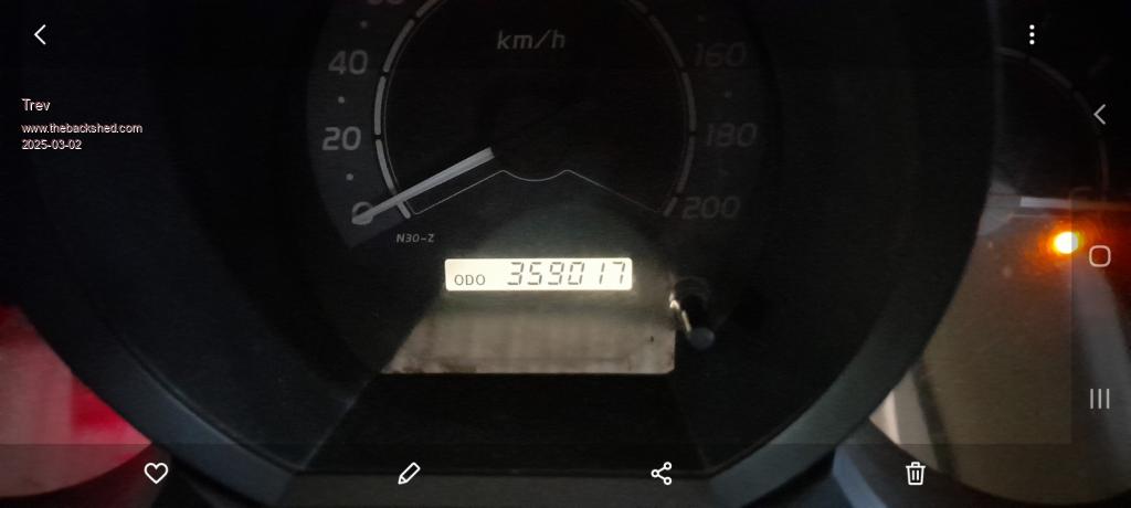

I keep forgetting to post the speedo reading at the start.
I also tested the range expected at 100km/hr. I will write them all here for easy comparison.

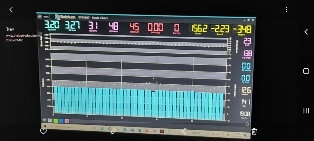

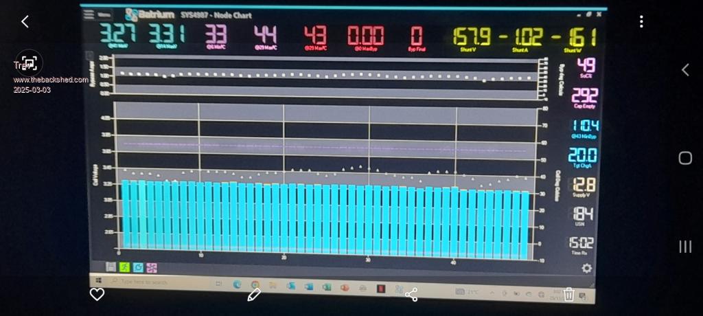

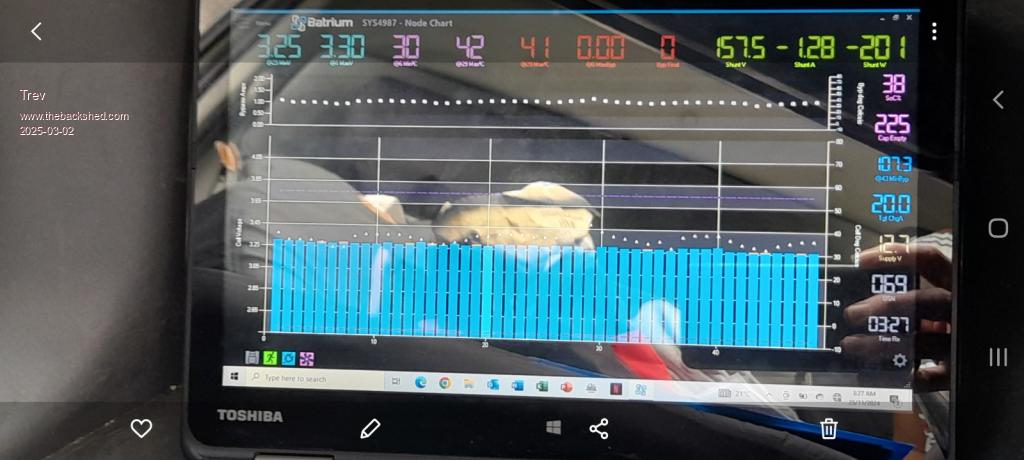

Chargefox data for Cooroy.
Heat on the batteries became an issue again at Cooroy. The last 7% was charged at 80A. I had to turn 2 chargers off to keep temperature below 48C.
Left Cooroy at around 11.50am.

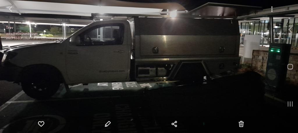

I wanted to charge next at IKEA North Lakes, but the app showed them not working. Spent a little time looking for another on the app, but decided just to head to IKEA Springwood (south side of Brisbane).
Much crawling bumper to bumper on the freeway coming into Brisbane. Drove at 80km/hr where I could.
Drove 153km. Arrived at IKEA Springwood 2.40pm. Used 51%

Pete, we have around $40,000 of electric parts in this Hilux. Just over half of that is batteries. Dale has put in a lot of other extras on top of that as well.
Cost to convert really depends on what vehicle you use and what you want to achieve with it. We have a big battery pack ($22000) and $6000 worth of chargers ($1000 each). We wanted fast charging and long distance driving. Most conversions will have half that battery size and 1 or 2 chargers. My EV Hilux only has 300Ah (half the size of this Hilux,  Dale's Hilux), but I am using Winston batteries which are a bit more expensive than EVE. Winston are known and trusted to be good.

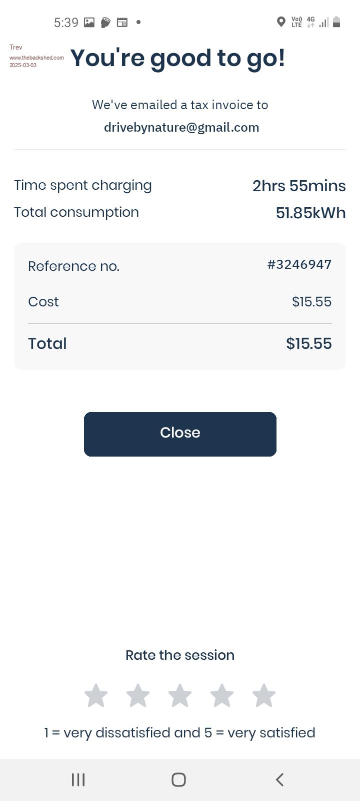

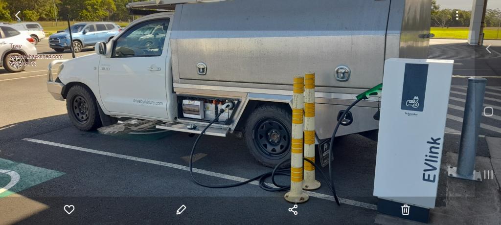

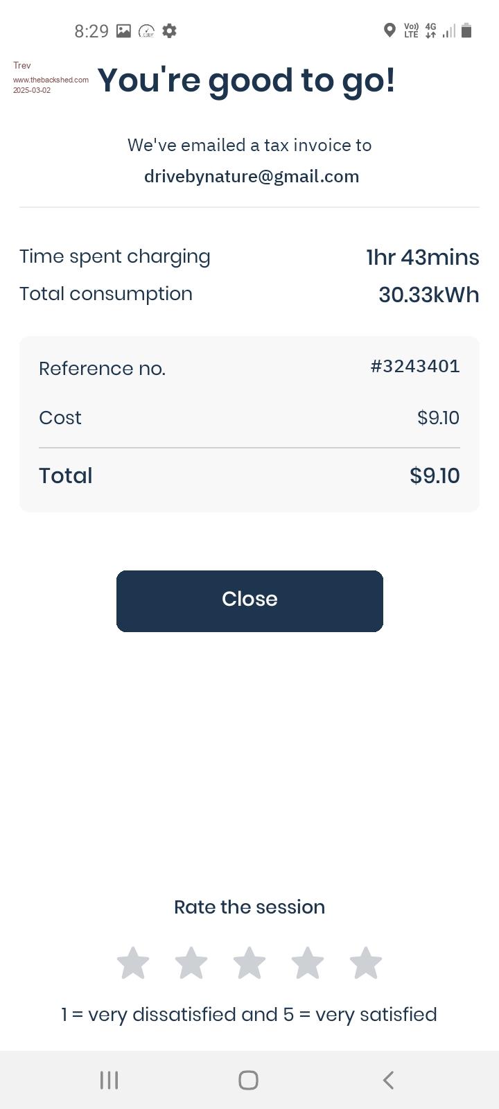

Chargefox data for IKEA Springwood.
Left IKEA at 1.45pm
Drove 156km mostly at 80km/hr.
Arrived at Lennox Head at 8.46pm.
Used 51%.

I didn't get a picture of the battery screen and I can't remember how much power used.

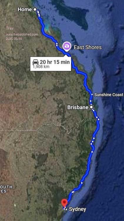

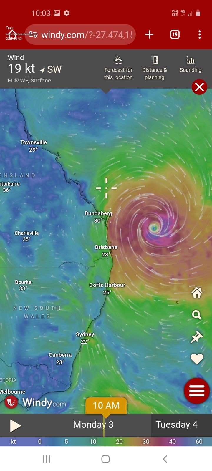

Current position of cyclone Alfred, while I am charging at Coffs Harbour show ground. The cause of all the strong head winds. Hopefully the wind will ease off as I get further down the coast.

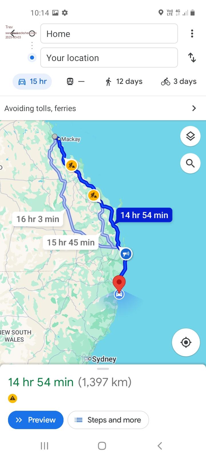

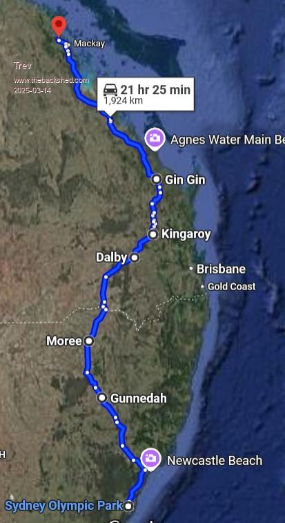

Trip so far. Destination-Sydney. This info is more for those in other parts of the world who are watching this EV drive.
Edited 2025-03-03 09:19 by Trev

Posted: 11:25pm 02 Mar 2025
Apart from the wind, you wouldn't know the cyclone is out there. White puffy clouds and blue sky.

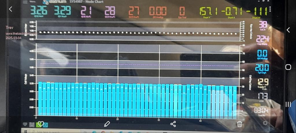

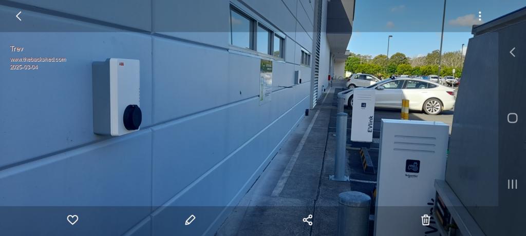

Posts: 676

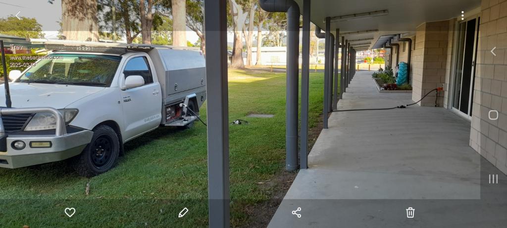

Posted: 06:39am 03 Mar 2025
The last bit of charge had to be slower to keep the battery temperature below 48C.

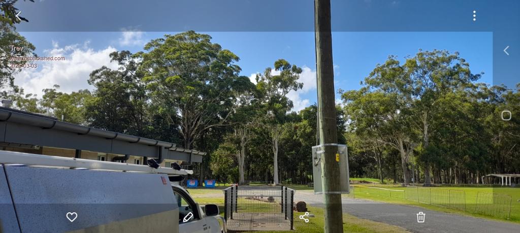

No charge data from Mid Coast Council as it is a free outlet. Thanks heaps. I noticed 2 new wall outlets and wires hanging out of the wall for a third outlet
Left Mid Coast Council at 8.06pm.
Stopped in road works quite a bit north side of Newcastle. Drove to Cooranbong to my brothers place, 192km mostly at 80km/hr. Arrived at 10.57pm.
Then this morning drove to Morriset for a charge.

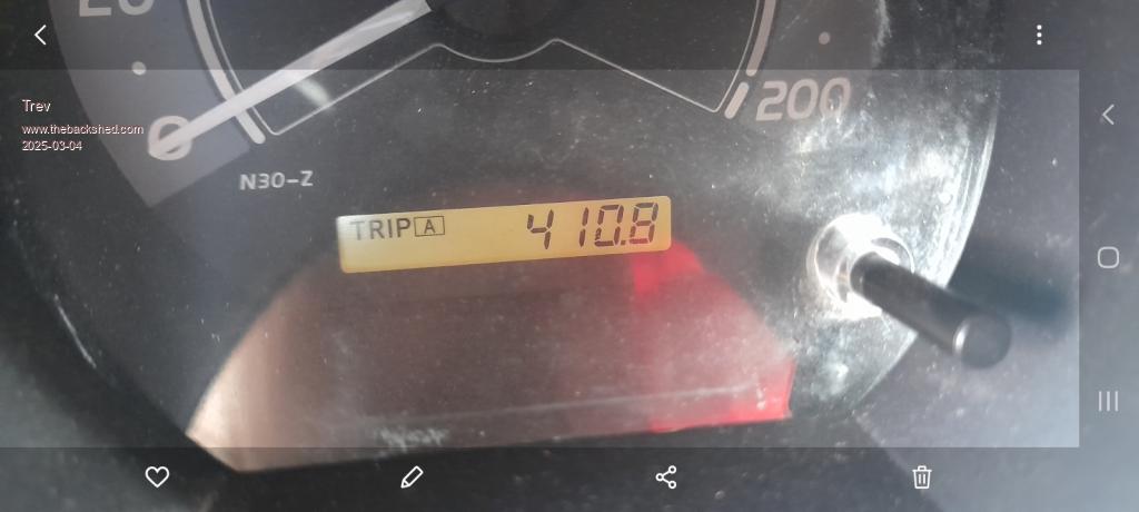

I forgot to zero the trip meter at Mid Coast Council so it is 411km - 215km = 196km. Used 62% or 600-224Ah = 376Ah.
