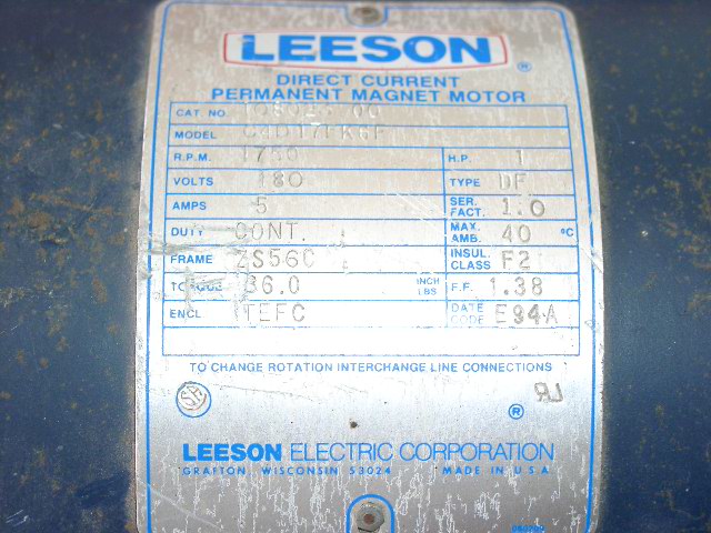

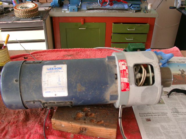

Posted: 02:48am 13 Apr 2008
Hi Crew,, The original "Gentle-Annie" was a f&P motor with around 12 wires coming out .. I re-configured these best I could ,but the results were dismal,,they needed a gale to start them ,had Aluminium windings ..
very coggy,,I removed the rotor from one and removed the magnets ,,nice curved ceramic's. these rotors have a springy steel fine wire wound around the complete rotor,over the magnets....
I've still 2 of them .
yesterday , I scored a 1 HP dc (180V ) Leeson motor and electric brake -looks in perfect condition--now there's a possibility ---
Bruce

Posted: 12:34pm 13 Apr 2008
Hi Bruce,
The motor might be useful with a gearbox. This will be a brush motor with a wound rotor with commutator. This would be very useful as the motor powering your test setup. I would make up a 5 to 1 reduction drive with a cog belt etc. The power supply would be a 500W, 110V isolation transformer with rectified output. A decent filter cap to smooth the DC. A simple PWM mosfet chopper with a LC filter and freewheeling diode on the motor. I used a similar cct for the drive on a solar car. This would provide an infinitely variable speed control to the motor. The input power is easily measured. The efficiency of this motor would be superior to a squirrel cage induction motor. The power in v output could be more easily compared for many different setups. You may wish to discuss this further.
cheers, Gordon.

Posted: 08:04pm 13 Apr 2008
Hi Gordon,,,
I just knew you would love me to bring this home from the tip-shop .. We'll talk about a Cct and a tranny soon. Gee,all that nice work I done ,,and now I'm thinking of pulling it apart before it's turned 1 rpm?.
Oh well,,thats life.
Thanks ,
Bruce

Posted: 08:22pm 14 Apr 2008
Hi Bruce
The Dc motor will work but being permanent magnet I would earmark it for generator projects. A AC universal motor , old skill saw drill etc would work just as well in fact price new no need for old. Can run them on a reduced DC voltage that can be varied by electronic,resistive, or best variable voltage transformr .
Dc eliminates pf in current measurement but still loads inaccuracies use torgue to measure input
Herb
